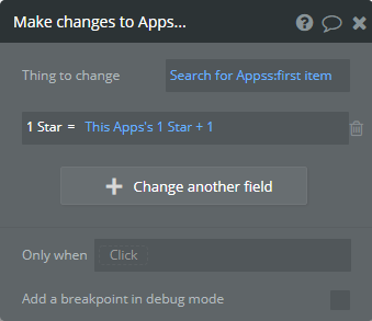

I want to add a +1 from the interface into a particular numeric field of a particular row in a database. NOT the first item (which seems to be the only thing that works!). Why isn’t this easier to achieve?
Issue
I tried doing a “search for”, finding the dB name and specifying the UniqueID, but this results in red text of death. This technique has worked well for accessing particular fields, but doesn’t seem to work for modifying a field.
Any help is much appreciated.

Let’s say I have 2 Apps (so 2 rows in the dB) - how do I specify that the +1 has to be for App number 2’s 1 Star field?
When I try using UniqeID this is the error:
The only way I can get rid of the error is by specifying “First item”.

Seeing the illustration you just added, you will need to add :first item at the end of the Search for apps to specify that you want to edit that particular App.
Right now, you’re giving Bubble a list of apps (even if the constraint you have will only return one app, it’s still technically a list)
Oh…So First Item won’t just pick the first field in that particular row?
It will pick the first item in the search result you are producing. So in most cases it will depend on how you are sorting the results. In your case, as you are specifying a unique ID, the list will always produce just one result. So you can safely use first item to “convert” the result from a List of Apps, to one App.
Ahhhhhh! D’oh! My assumption was first item related to the underlying dB, not the search. Thanks so much for clarifying!!
