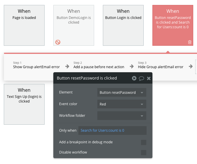

Like @tart2000design, my app has a search:users first (inherited from the template I started with), to see if the email exists in the database. It worked fine in the development site, but now in live I have to expose the emails to “Everyone else”, which is not ideal.
My questions are:
  • how bad/terrible is exposing the email only on that search? (I assume very bad).
  • should I just get rid of the search all together? Not great for UX, but on the other hand, nothing is lost if a bad reset email is sent. Hopefully the user realises the mistake soon enough.
I ask because I consider myself only medium level in Bubble so I can’t really follow up the couple of solutions you discussed.
Thanks!
Why do you need to search for users? The PW reset page/feature should be enough. If the user fails getting in, they should be asked to resubmit their email and then you run the actions again.
Would not recommend exposing all your users.
Well, if the user inputs the wrong email , then the link/token will be useless, and also the user will never get the “reset your password” email, so there’s some logic to search first. You can see the problematic workflow here:
But I’m with you it’s not worth exposing everyone for this functionality.
