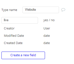

Now - here is my question - My live stream will only be available a few times a day. So on the other times, I want people to be directed to a different home page (like the landing page above). How do I make this work if all users will be directed to the same homepage link?
Create a new datatype called Website and add a yes/no field named ‘live.’
Then in a workflow, use a ‘Do when condition is true…’ event to navigate to another page only when live is no.
You will have to manually change the first item of Website’s live to yes or no.
Hope this helps!

This makes sense but one question - which is very basic - how do you make a new datatype? Does that mean a new page?
I’ve already made two pages. One for when it is active and one for when it is non-active. Now I just need to do what you suggested above to connect the two.

Find it on the Data > Data Types tab of the editor:
You might want to refer to the Bubble Manual. Here’s the section that describes the Data Tab:
https://manual.bubble.is/working-with-data/the-data-tab.html#the-data-tab

To be clear when you say “manually change the first item of Website’s live to yes or no” - I will change this section to say yes / no? Or is there another area where I do this?
Thank you for your patience.
Go to App Data, Website, and click the pencil icon to change the field.
