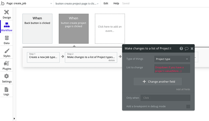

But I don’t seem to get around adding the new job to a particular project. Here’s how I’m setting up my workflow below:
You don’t want to make changes to a list of projects (i.e., you are using the wrong workflow action)… you need to make changes to a single project, and the project to change is the one selected in the dropdown. The change to make is to add the result of step 1 (i.e., the newly-created job) to a list field (that is linked to the job data type) on the project.

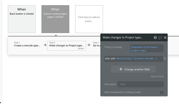

Does this look alright?
Yup, it looks right… should be pretty easy to test, too.
Thanks a lot for you help @mikeloc and @Qaiser
