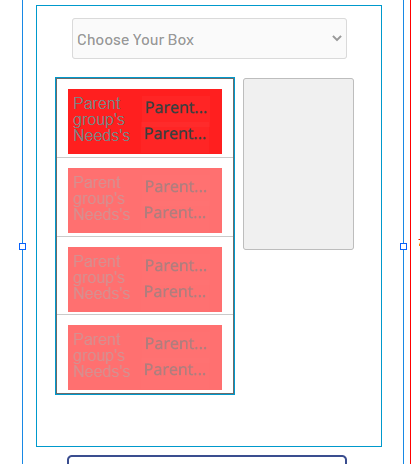

I have a series of things (“needs,” like eggs, apples and muffins), which I’m trying add to a “box” for users. Boxes are their own type of thing, which have a list of “needs” that are included in them (from my knowledge this was the best way to set up the process).
I thought it would be nifty to this via a drag and drop group.
Act 1: Set up a repeating group with all the needs that are ordained worthy of going into boxes. Within that group there is a (red) drag/drop group. (Data type:needs)
Act 2: Setup a drop-area for people to drop the need into. Every time they move a need into this area, it gets added to the list of needs within that box. The grey box in the above photo. (Data Type: Box)
Act 3: Get confused why the workflow won’t let me do that.
Is this possible? Or do I need to think outside the box? I haven’t found anything to say that the data type of drop group and drop area have to be the same. Is that the case?
They have to be the same.
Think of grabbing an envelope from a basket and putting it into another basket. Both baskets need to hold envelopes … and the only thing that travels is an envelope.
… sorry for the bad analogy! :grimacing:
Okay, thank you. It would be great if this could be a new functionality for future versions. Because adding “items” to a “box of items” is a fairly common database functionality.
