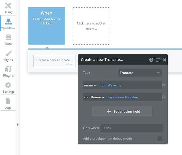

Then in the workflow that creates/modify a thing with your text field, you will include adding the shortened text field too.
See example below:
Again this may not be the optimal solution but it works. Normally i try to avoid using plugins as they may slow your application a bit but i haven’t been able to come up with any better solution without using javascript expressions.
