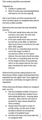

Right so here’s the pseudocode I’ve come up with so far. Like I said, I’ve been working on doing this natively in Bubble today and last night, and I’ve gotten some progress. It just feels like with this level of complexity, it would be easier to give an AI tool this pseudocode and let it figure out the exact specifics of how to get it done.

Okay that’s great. Don’t use AI for this unless you just really can’t be bothered to build the logic because the AI will not be predictable.
Each of your bullet points are essentially a ‘Make changes to thing’ action which have a condition attached as you describe.
Then, you can do the same Make changes to a thing with conditions for the Eisenhower Matrix (just break it up like you did for the first section).
For the triggers, you can schedule a backend workflow to run when a Task is changed, and also schedule a recursive workflow that runs daily and schedules itself to run 24 hours from now. This recursive workflow kicks off the task sorting workflow.
I don’t know how familiar you are with backend workflows/recursive workflows but there are plenty of good tutorials on Youtube if you need guidance!
