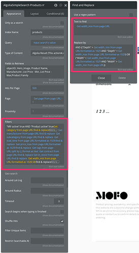

The most common causes of AND/grouping problems are extra escaping (backslashes/quoted attribute names) and mismatched field names/types in the Algolia index. Algolia expects attribute names without surrounding quotes, and parentheses/AND/OR are supported - so your logic is fine if sent in the correct syntax.
Please try this exact string in the plugin Filters input (don’t add extra backslashes or wrap it in JSON quotes):
Mfr_active:true AND Product_active:true AND ((Depth > 90 AND Depth < 100) OR (Width > 90 AND Width < 100))

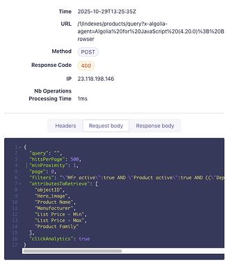

Thanks for the extra screenshots - they helped. From the request body you pasted it’s clear why Algolia is rejecting the call: the filter string is being sent with escaped quoted attribute names (e.g. \"Depth\") which breaks Algolia’s parser. Algolia expects unquoted attribute names / plain numeric comparisons in the filters string.

  1. Paste a static filter string (no dynamic expressions) into the plugin Filters field - copy this exactly and save:
If that works, it confirms Bubble’s dynamic-data insertion/escaping is the cause.
  1. If you need dynamic min/max values, build the final filter as plain text before it reaches the plugin (so Bubble does not insert JSON quoting). Two approaches:
  • Create a single text field on the page (or a custom state) and set it with a workflow that composes the full filter string (e.g. Mfr_active:true AND ... (Depth > [min] AND Depth < [max]) ...) and then reference that page field (not a dynamic expression nested inside JSON). Using a workflow action to set a text value avoids Bubble double-escaping when rendering plugin properties.
  • Or call Algolia from the API Connector (server-side) where you control the raw request body and can pass the filter string exactly.

  • Bubble is inserting escaping/quotes when plugin property contains dynamic parts or when the editor serializes the property into JSON for the request. Algolia needs the raw, unescaped filters string.
If the static string above still results in escaped quotes in the API call, please paste a screenshot of the exact plugin property (the Filters box) after you saved it - we’ll check whether the plugin or Bubble is altering it on save.

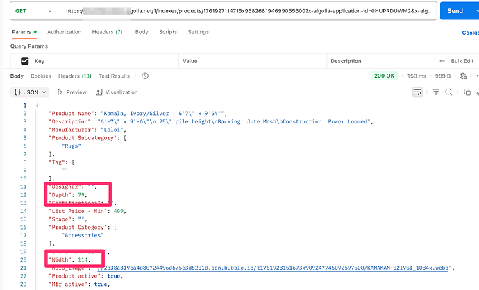

"filters": "\"Mfr active\":true AND \"Product active\":true AND (Depth_in_5_100:true or Width_in_5_100:true)"
This got rid of the error! However it returned no results back. This was an unexpected result since the screenshot shows as least 1 product that fits the criteria.

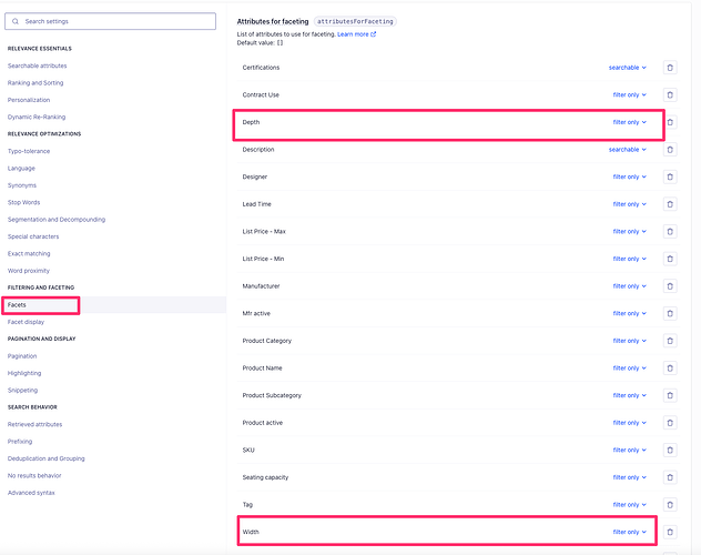

Does using the precomputed boolean attribute need a different set up in Algolia, e.g attributesForFaceting? I currently have Depth and Width set up for ‘filter only’.

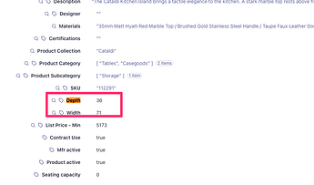

  1. Confirm the attribute exists in the record
  • Open the record in the Algolia Index (dash → Records) and view the raw JSON for that specific object. Verify you see exactly Depth_in_5_100: true (boolean) and/or Width_in_5_100: true. Case and spelling must match exactly.
  1. Ensure the attribute is allowed for filtering
  • In Index settings → Facets, add Depth_in_5_100 and Width_in_5_100 (if not present) and set them as Filter only (or selectable for faceting). Save and reindex (if required).

I think there was a misunderstanding. The attribute is Depth and it has a numerical value, i.e Depth: 5(See screenshot).
I don’t have any attributes that are Depth_in_5_100. So If I search Depth_in_5_100:true I presume it’s looking for a specific attribute called Depth_in_5_100 (which I don’t have) rather than a Depth value between 5 → 100. Did I misunderstand that?
To clarify - I’m trying to search all records that have either a Depth that is >=5 or <=100 OR a Width >=5 or <=100.
Solution was actually very simple, I just missed it when I was reading the docs:
"filters": "\"Mfr active\":true AND \"Product active\":true AND (\"Depth\": 5 TO 100 OR \"Width\":5 TO 100)"
