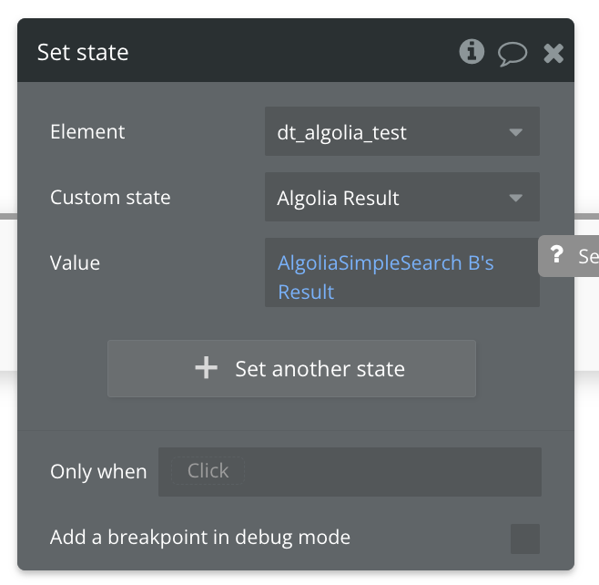

Is it possible use this to set a custom state? I downloaded the other algolia plugin but now want to use this one due to issues with the other one. with teh other one I exported the data from Bubble and uploaded CSV to Algolia. Linked API. Getting great results in a repeating group. Repeating group displaying fields 1 - 5 have added a check box in each cell but now having trouble saving the field1 value

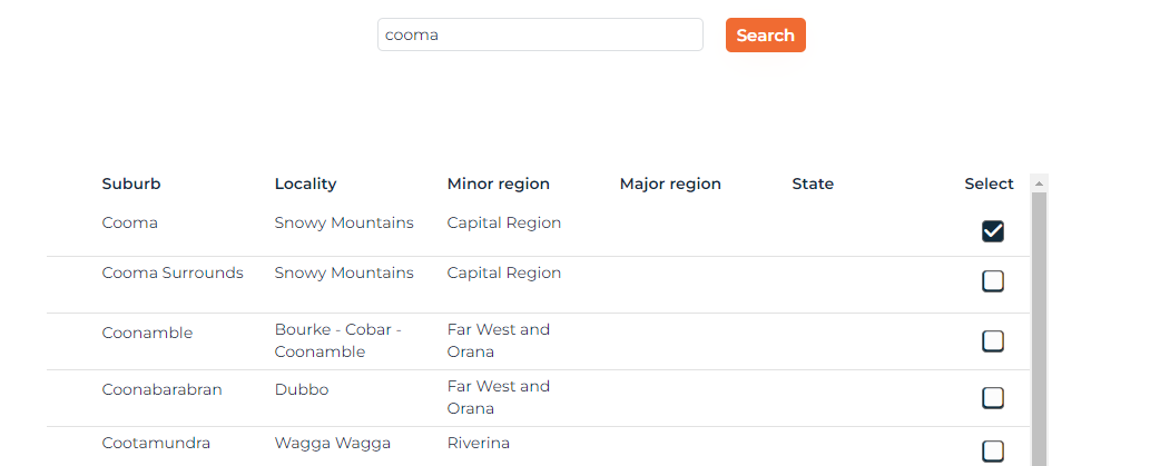

How do you select an item from your list of results to add to a custom state? I exported the data from Bubble and uploaded CSV to Algolia. Linked API. Getting great results in a repeating group. Repeating group displaying fields 1 - 5 have added a check box in each cell but now having trouble saving the field1 value
Hello @CRi77y-T,
Thank you for getting in touch :pray:
While we’re not entirely clear on your specific use case or requirements, you can configure the result of Algolia searches to be stored in a custom state. Below, we’ve included some screenshots showing how we set this up on our end.
Screenshots
We encourage you to experiment with the plugin, and we hope it helps you achieve what you’re looking for!
Should you run into any issues or have any questions, please don’t hesitate to contact us here on the forum or by email at support@zeroqode.com.
Best regards :sunflower:
Thanks for the reply, However your suggestion adds the results of the search to a set state I only want to add some of the results from a an RG example the item with the checked box
Hello @CRi77y-T,
Thank you for providing those additional details!
Yes, you can still store the information in a custom state. When you want to save a simple text from the RG, ensure the custom state is of the Text type (probably this is the reason you get an error when setting up “Parent group’s text”. A crucial note here is that “Parent group’s text” will only fetch information from “field1” or the one you have added in the Repeating Group
Additionally, you can use dynamic data such as “AlgoliaSimpleSearch’s Result’s fieldX:item #Current Cell’s index”, where X represents the field you wish to store. This method will capture the information of the current cell based on the specific field you’re interested in saving.
Please continue to experiment and discover the setup that best meets your needs :pray:
Best regards :hibiscus:

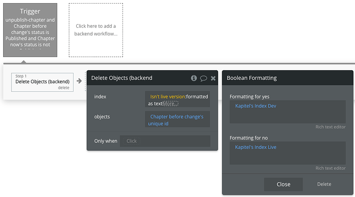

I use your plugin and am usually a big fan. However, I have a problem when I try to delete an entry from my Algolia index via a backend workflow. The entry is simply not deleted and when I look in Algolia’s API logs, I find a 400 response that reads as follows:
“message”: “Not enough rights to delete an object near line:1 column:93”,
“status”: 400
Actually, I should have configured my keys correctly in the plugin, as both the search and the addition of entries work without any problems. Do you have any idea what I am doing wrong or what the error code means?

Hi,
I have set up a database trigger that is activated every time a certain change is made. In this case, the database item “Chapter” is to be deleted from my Algolia index. To do this, I pass both the index and the ObjectID in the backend workflow. The identifier of the index is stored in an option set. Depending on whether a database item from the dev or live environment is changed, either the dev or live index is addressed in Algolia. The ObjectID of the Algolia item corresponds to the uniqueID in Bubble.io.
I have already checked whether the database trigger is triggered. For this I created a Create a new thing workflow next to the Delete Objects (backend) workflow and saved Index + ObjectID in Bubble.io. This worked without any problems. I also tried not to pass the index ID via an option set, but to enter the ID of the index directly in the index field. I also tried the same with the ObjectID (fixed instead of dynamic coding). Everything led to the same result: 400 response.
If I trigger the workflow directly from the frontend, however, it works. It also works if I move the Delete Objects workflow to an API workflow and trigger it from the frontend. The error only occurs if I run the workflow from the database trigger.
Note: The database trigger is triggered due to a Make Change to list workflow. Consequently, it is triggered several times within a short time, but I do not get a rate limit error, but a 400 response with the first change made.

Hey,
sorry for the late response and thanks for the little reminder.
Without me having made any changes, the problem had resolved itself in the last few days until it just reappeared.
I went searching again and found the following: When the delete object (backend) is triggered via database trigger from the live version, it uses the wrong key (search key instead of write key, I can see this in the API logs of Algolia), although I have actually configured it correctly (see screenshot).
The error does not occur in the bubble dev version, only in the live version and only if the delete action is triggered from a database trigger. Add and update actions from the backend also work without problems using database triggers.
Is that perhaps enough to help me? Since this is already a running app and the problem is only in the live version, I’m a bit worried about giving others such extensive access. However, if there is no other way, I would simply contact the email you provided with the details.

Hi @florian.adomeit,
Thanks for the details and apologies for the delayed reply over the weekend :pray:.
We think we understand why the delete function is not working in the Live version. Firstly, it is interesting to know that it has been working from time to time, as the Search Key does not have any permission to delete objects. Since you are using your Write key in the test version, it is normal to notice some things working in the test but not in the live version.
The Delete action is using the key from the “api_key” field, and as we see from the screenshot, the key itself is only for search. If you could create a new key and provide it with search, delete object, add object and logs permissions, this one key will have enough permission to do everything without giving admin permission.
Could you please try it out and see if this resolves the behavior?

But one more question in advance: Do I really have to configure an extra API key for this or can’t I just enter my Write API key in the API key field above?
I would also like to point out that I have configured the plugin as in your video: https://youtu.be/IWPAEWb89ko?si=Ai3eRGy8yRF_aMYr&t=175.
It’s a bit confusing when Add and Update actions work with it (because they obviously use the X-Algolia API key (shared headers)), but Delete actions from the backend don’t because they use the api_key from the top field. A hint in the documentation would be great!
