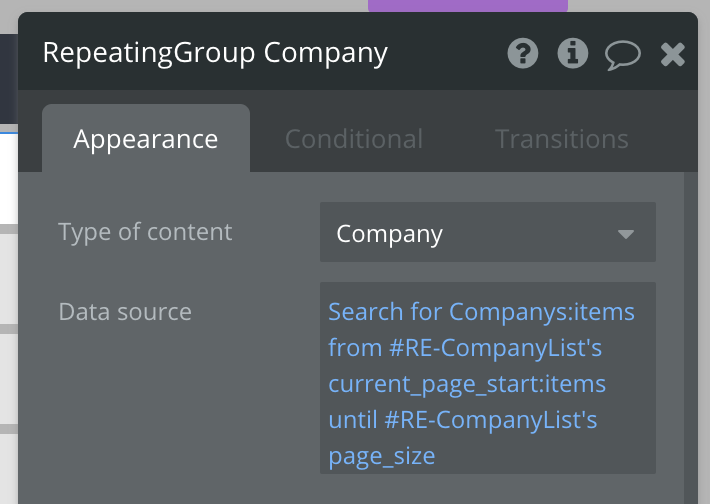

I tried to do the same method for pagination. I have 11 items and each page contains 5 items. So I have 3 pages. On the first page and last page it is working. But on the second page 1 item too many is shown. This item is also shown (correctly) on the last page. Can you see what I am missing? Please look at the screenshots below. At the bottom the value of the used custom stated are printed.
Page 1
Page 2
Company 9 (11th in the list) is shown, which shouldn’t be. Start item is 6 and end item is 10. This implies 5 items, but 6 items are shown.
Config of Repeating group
** Page start/end calculation**
The start and end item number of each page are calculated using a custom event.
Thank for the help.
Solved it. I misinterpreted “items until #” expression. It just counts the number of items from the defined start. So when I changed “items until #RE-CompanyList’s current_page size” it works like a charm:

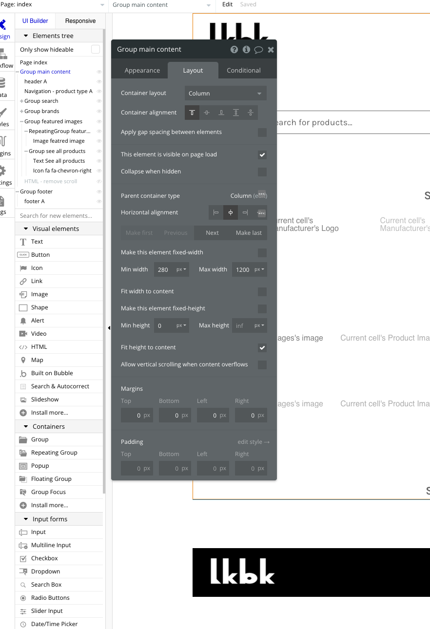

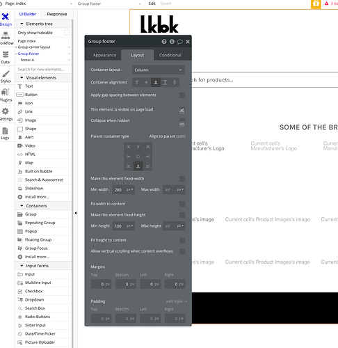

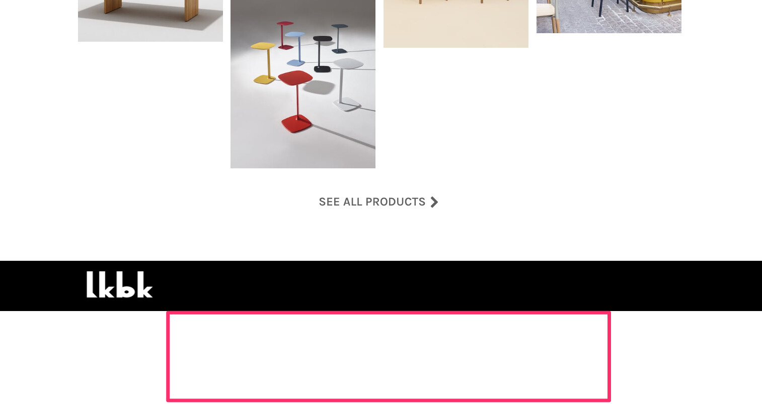

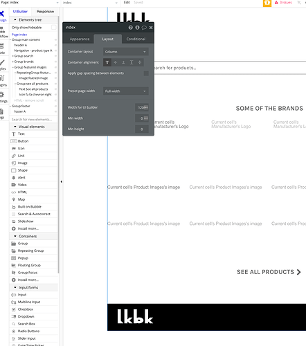

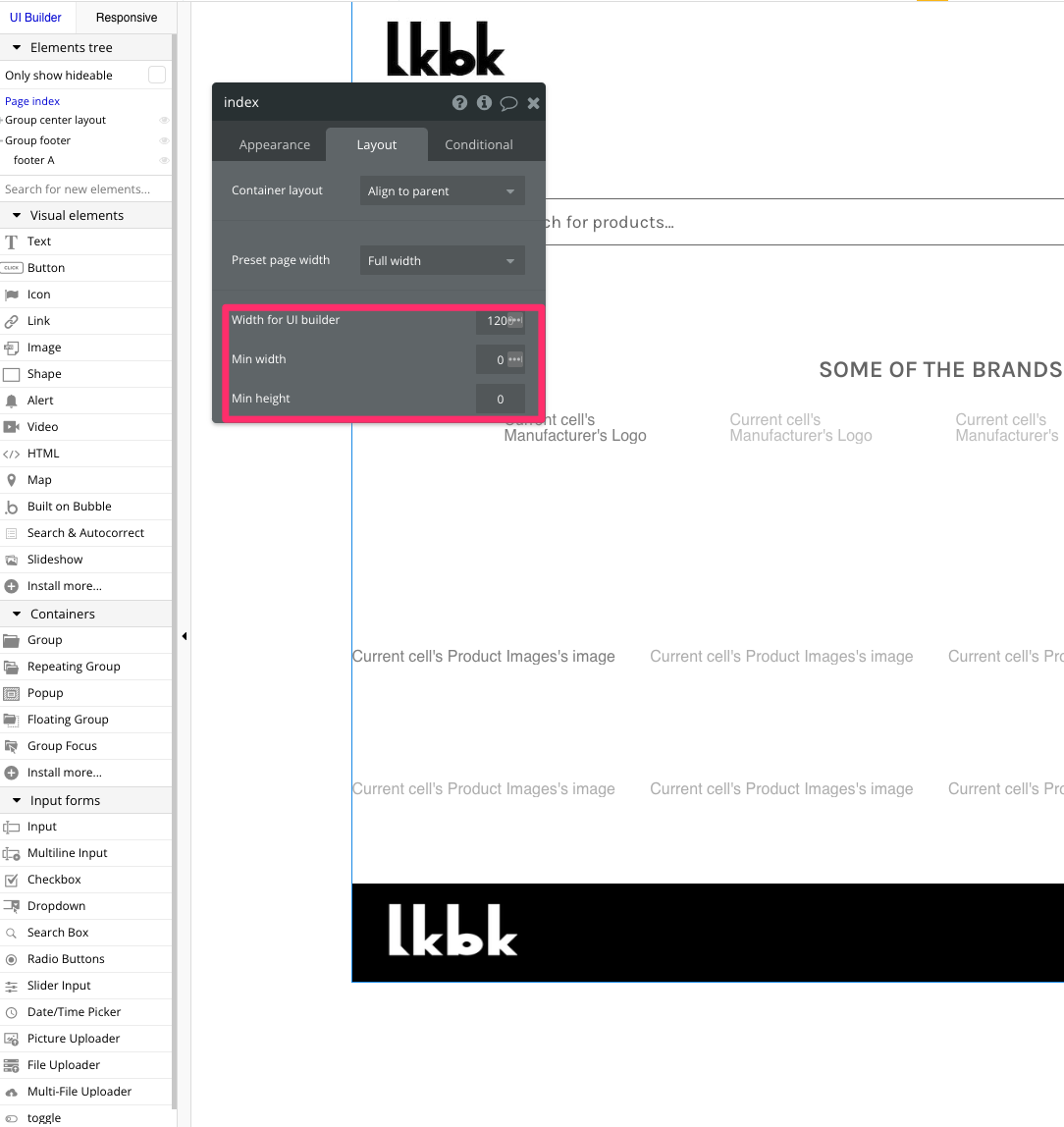

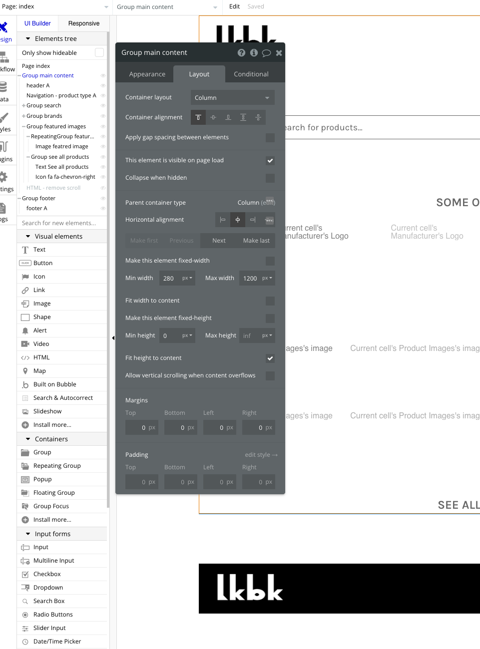

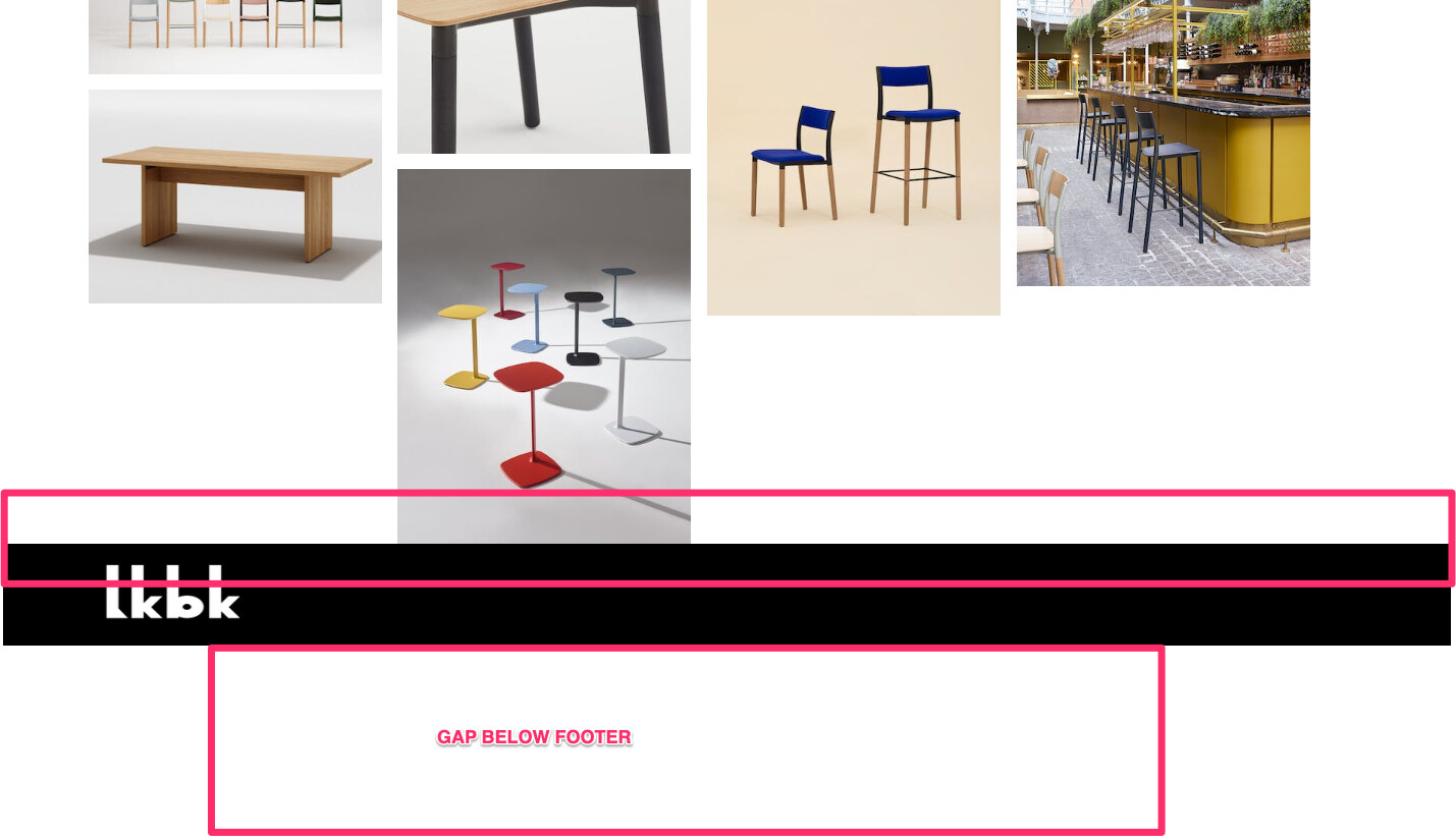

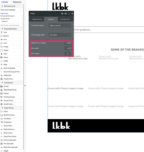

I’m having a problem with this as well. Every page I’ve ever built on Bubble seems to have similar issues. Below the footer there is a gap between it and the bottom of the page (?debug_mode=true is not in the URL).
I’ve tried the suggestions on this page:

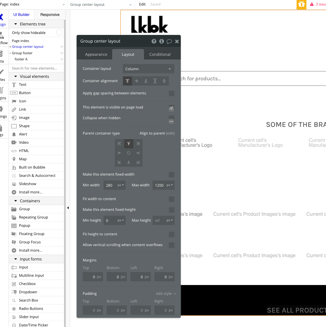

  1. Creating the page as ‘align to parent’, making the min heights 0 and pinning the footer at the bottom of the page and other content to the top. Issues here: a) not aligned to bottom of the page and b) it actually overlaps the ‘Group center layout’ above the footer group.

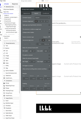

  1. Make the page a column, aligning the main content to the top and and footer to the bottom. Setting min height to 0 for the main content and choosing ‘fit height to content’. This means there is no overlap between the footer and main content but there is still a gap below the footer.

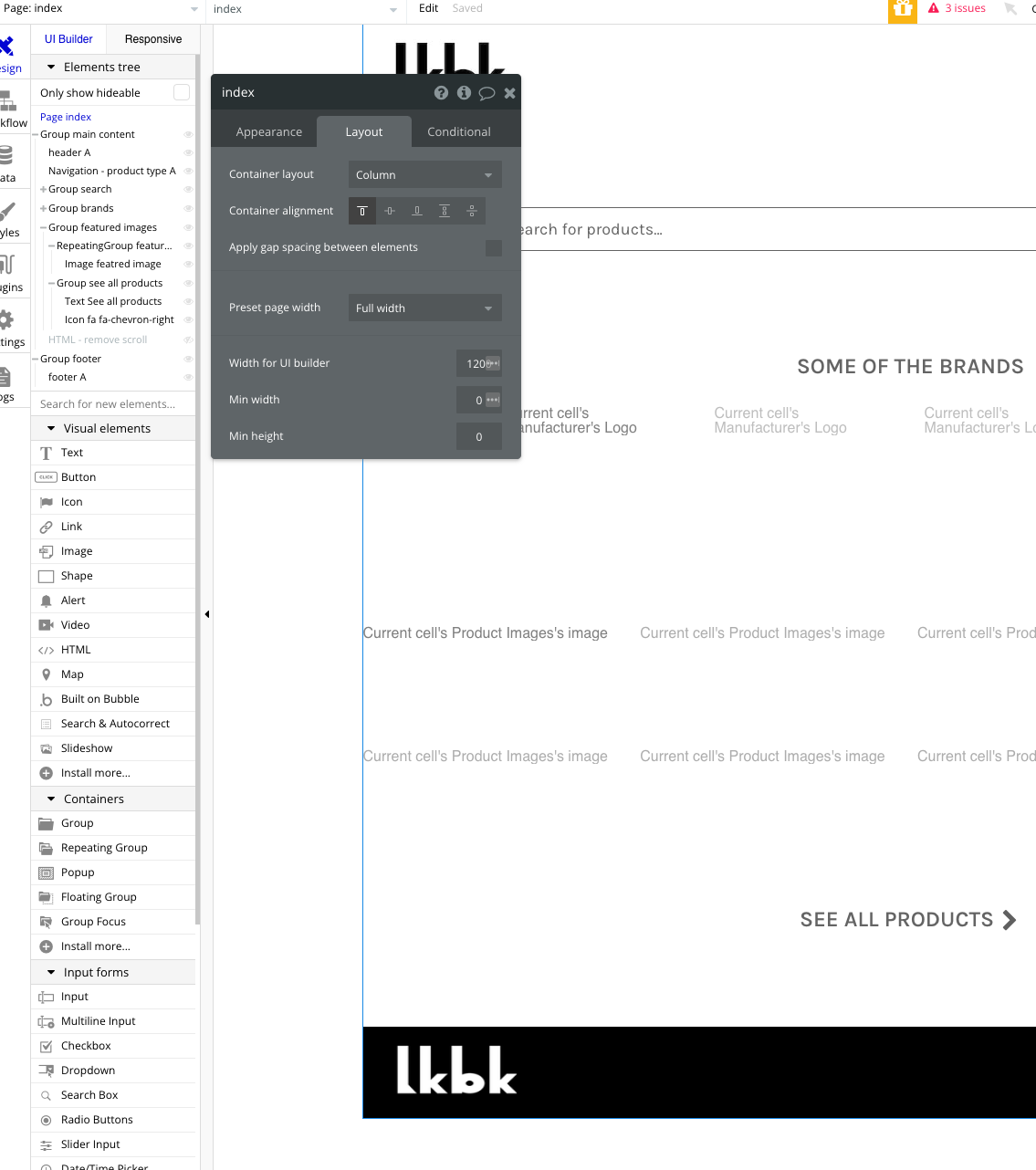

Found a solve for this issue:
  • Make sure your page is a column layout
  • Place your header and your page’s content inside a group that fills 100% width so you don’t even notice it’s in a group
  • Place your footer outside of this group
  • Align the page as a “space between” container alignment
This keeps the footer at the bottom no matter how big or small of a page and the relevant page content in a normal spacing from the header. The amount of white space between the end of your page’s content and the footer will then be dynamic.
