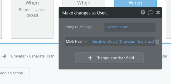

That’s correct.
In your API settings in the API connector you should set it as an Action with the appropriate data that it can return.
Then you can access it in the workflow under Plugins. When you do that you’ll be able to assign it’s return data to your database by saying Create New or Make Changes and selecting the return value from your API - it will look like return from step 2 or 3 or 4 of the workflow…
Give it a try…
