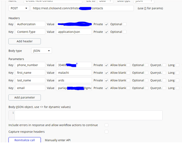

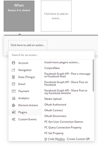

I am having trouble using a ClickSend API that i just connected in the API connector. The trouble is coming from my inability to find the API in the workflow editor. This is not my first API but it is my first time running into this problem. Does anyone have any solutions?
To anyone who runs into this problem the “Use As” option at the top of the specific api needed to say action. After doing this the problem was solved.
