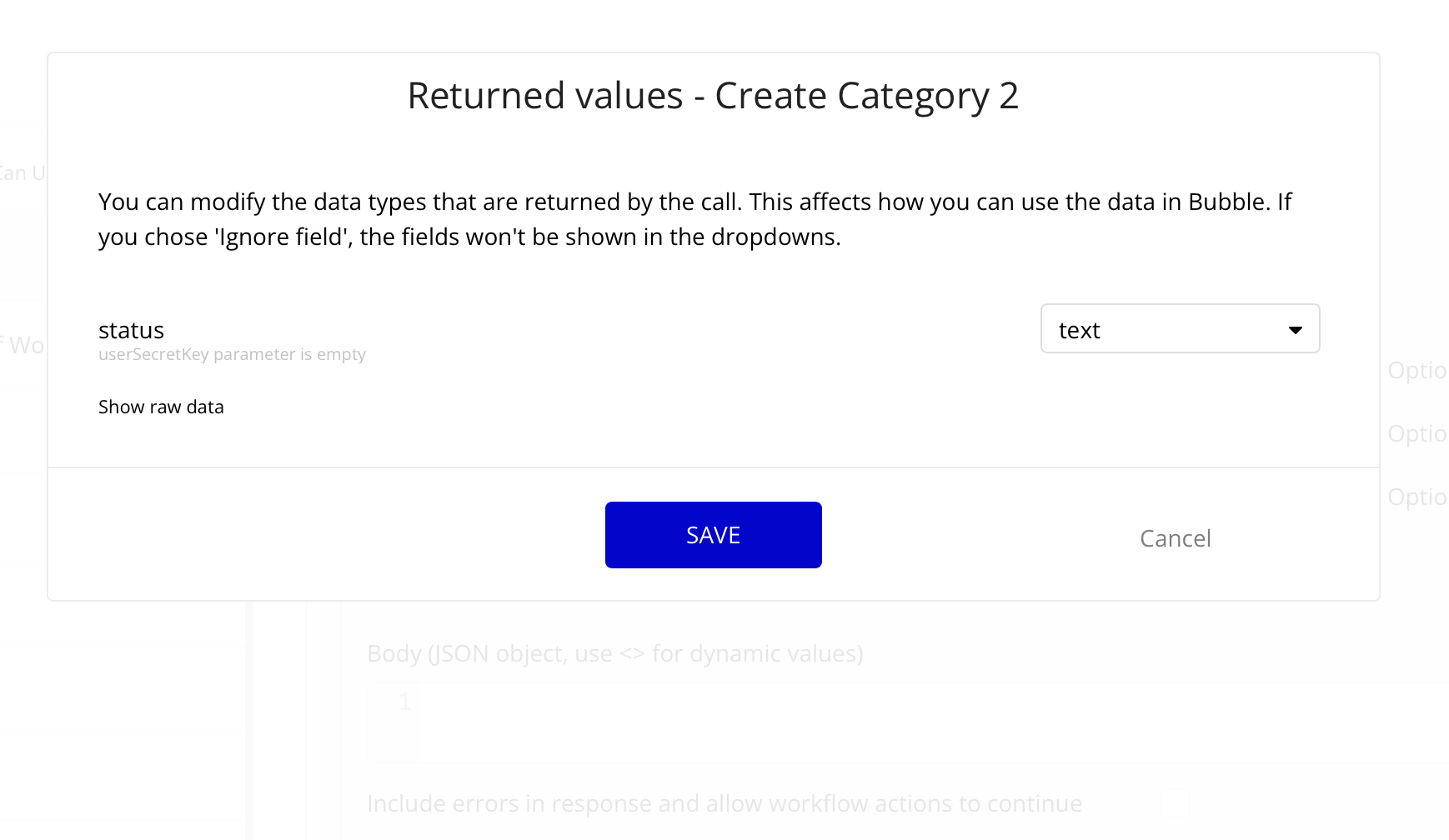

Basically I am trying to integrate a payment gateway (Toyyibpay from MY). I have followed their documentation to send “userSecretKey” as one of the parameter, but the API returned below error.
Here is my setup
What could be the cause here? I have followed their documentation here : https://toyyibpay.com/apireference
Can anyone point me to the right direction?
Hi @faisalkarimstubapp,
Unfortunetaly I get “this site can’t be reached” when trying to access the documentation.
Are you sure that you are supposed to send the key within the JSON body, and not in the header?
Hi @alanpieczonka ,
Thank you for checking out. Here is the docs : https://toyyibpay.com/apireference/ . It seems like the problem with my call is the body should be sent as form-data, not json.
