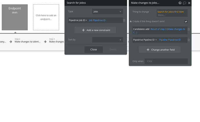

API End point … All of the entries get created they only fail in the last step
This step fails, and it seems to happen randomly. I got it to work once and second time it didn’t on the same data.
In saying it worked once, are you saying that step 4 created a new job on the first pass, and then on the second attempt with the same data, no new job was created? If so, that would make sense to me as the second pass would have modified the first job created because it is a make changes action.
And just to make sure this is pointed out, zapier is pointed to your live site, so just make sure you are deploying your bubble changes each time you try something…or, change zapier to point to your test site.
It is pointed to live site. It basically works just skips, the last step at random. Or so it seems that it is random. I know I am setting up something wrong, just don’t know what yet.
