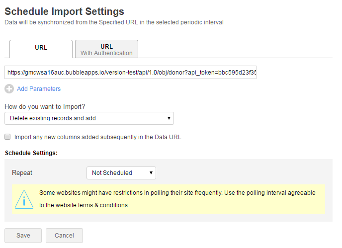

I’m using Zoho Reports, and the JSON API import only has one place to specify an import string.
To populate the initial data, I’ve changed the cursor in 100 increments, but this isn’t a reliable solution going forward, and doesn’t account for any deleted records.
How would I configure a solution to receive all the updates (or push them from Bubble), not just the first 100?
