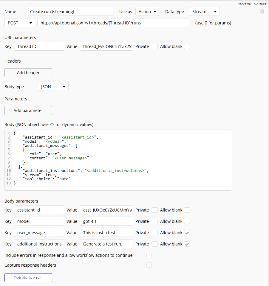

I added the “Create run” call via the API Connector, except this time with streaming.

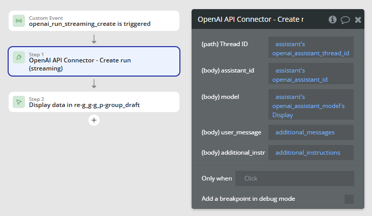

I have a custom event where this API is called titled “openai_run_streaming_create”. It has 2 actions, 1) create a run w/streaming and 2) display the result’s of step 1’s text stream into a group:
This custom event is part of another workflow:
The Problem
What I discovered is that with this current setup, the “Create Run” all will not run. Instead, I receive this error from Bubble:
What I discovered is that when the “Create Run” call is run from within the custom event, it will fail for some reason. But when I include the call directly in a workflow, it succeeds.
As another test, I rebuilt the same workflow, including with a custom event, except I used a “Create Run” API call that did not use streaming. This worked.
This issue seems to be that the call which has streaming enabled cannot be called from within a custom event, which has to be a bug.
If this is not a bug, can someone explain why this should not work?

I just wanted to let you know I’ve noticed some changes. I am now able to trigger this API streaming from within a custom event. This will be hugely beneficial. Thanks.
I just wanted to bring to your attention that although this is working, it seems streaming is not working. Instead, the content displays seemingly when it’s done on the OpenAI side, so not actively streaming.
I’m sure Bubble is already aware of this and is actively working on it, but I thought I’d mention it just in case.
