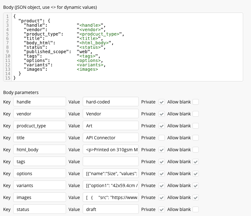

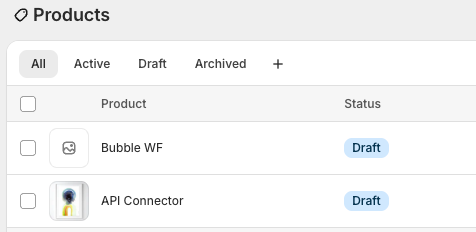

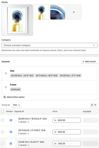

I have set up an API in API Connector that creates a product on Shopify. I have encountered a possible Bubble bug. As a test, all the values (except the product title) is hard coded, including options, variants, and images which are json lists. The product with the options, variants and images is created properly when I initialize the API. The same values also work in Postman. But when I call the API from a WF, the product is created but the options, variants, and images are missing on Shopify. I have created a bug report. But has anyone encountered this similar issue?

It works when I initialize. Images, options, and variants are created properly.

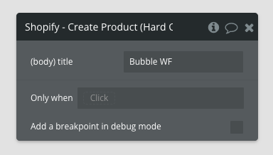

When I call the API form a WF, images, options, and variants are not created.

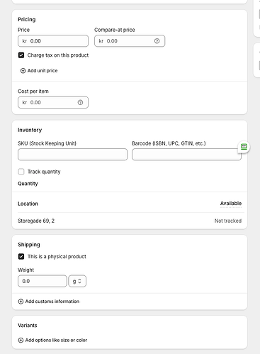

When I call a Shopify API from WF, it seems that some data are not passed to the API.

Uncheck allow blank
Yes, uncheck allow blank and it should work.
When we leave a parameter as Private and Allow blank checked, Bubble only uses the example value at Initialize time; when executing the workflow, it sends null.
