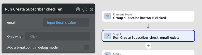

App Connector Bug or Normal?
No matter WHAT condition I put on the App Connector, it runs regardless. It couldn’t care less what condition it is. If the debugger shows RED, it still runs. Only thing that stops it is by putting a condition on the button ITSELF before it triggers the workflow. Not even putting it into a custom event works.
Is this normal behaviour for the app connector? I’m half tempted to just use API connector instead, how ridiculous.

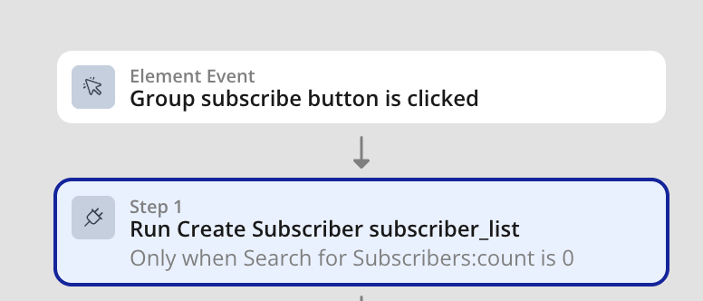

So are you saying a condition on a Make a change to Thing (Do a search:count) cannot be manipulated? If so I really need to stop listening to Chat GPT as it tells me to do backend via App connector as the front-end workflow is not secure and can be manipulated.
If a user inputs their email into a newsletter signup and clicks ‘subscribe’, if you used a Create a new thing (subscriber) ONLY WHEN Do a search of subscribers (contraint: email = this input):count is 0. It’s not secure as somebody allegedly can change that to 0 to fill your dB with duplicates.
So apparantly you’re supposed to use backend for that. So I have this:-
But the App connector does not respect Only when conditions @georgecollier. Is this normal behaviour for the app connector?

The search will run with whatever input the user has entered when they trigger the workflow.
Your issue is probably privacy rules. This search should, if your privacy rules are set up correctly, only ever be empty, because your privacy rules should restrict the email field such that it can’t be filtered on. If this field ever returns another subscriber (i.e count > 0) then it means that subscriber’s email is leaking…

No. Any search that has to bypass privacy rules (because you only want to verify the existence of something rather than permit access to it entirely) should be done on the backend and called from the front-end.

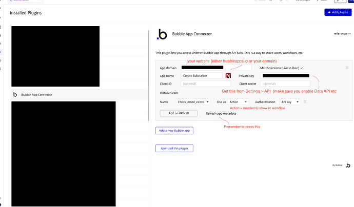

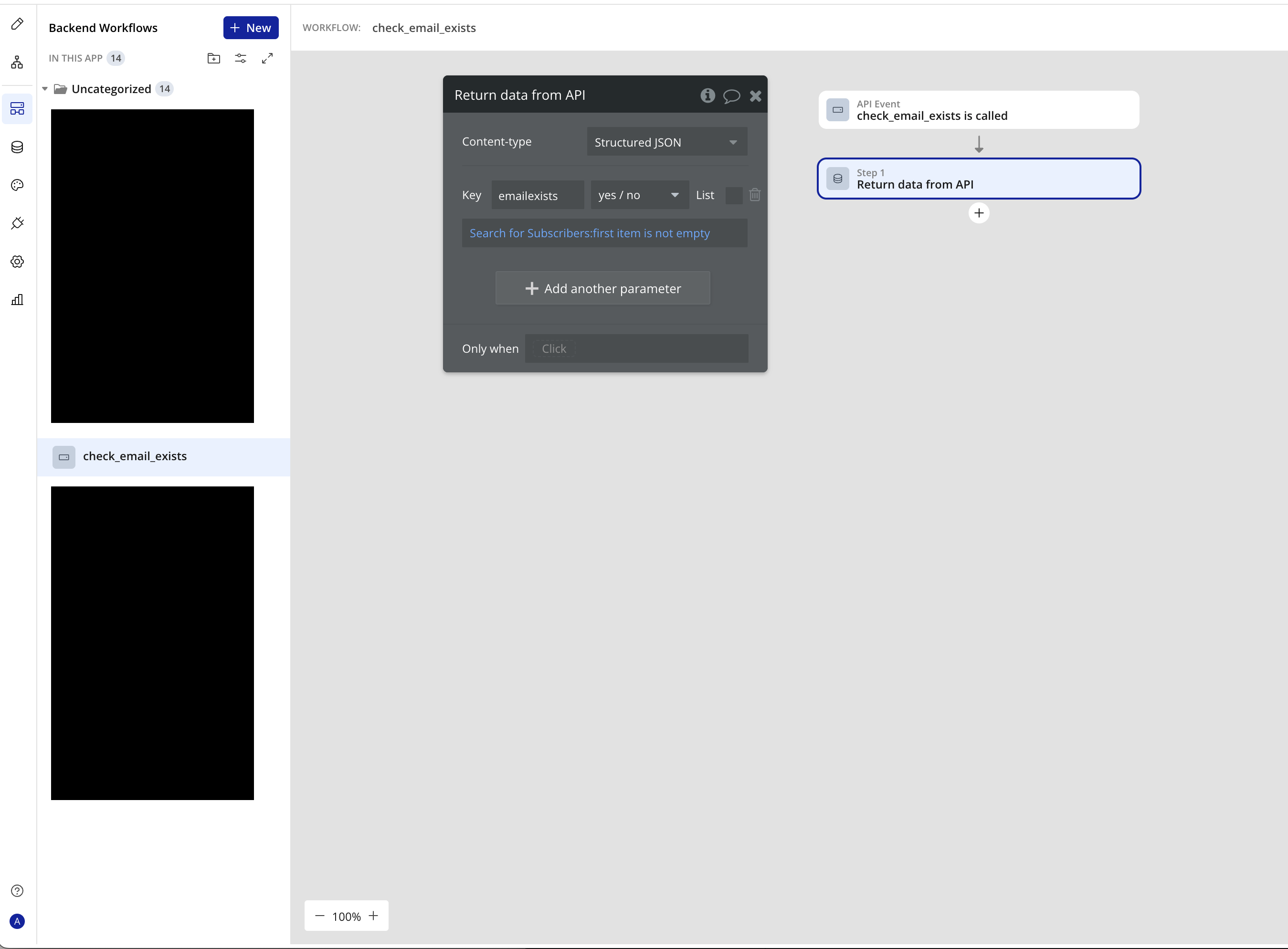

Nevermind @georgecollier I’ve grasped what you’ve said now. I’ve done an API purely to check if the email exists as a subscriber and called that from the front. Thanks for your time, you’re a star!
Tell me about it, I spend more time arguing back and forth. The amount of times it’s told me to do 6-10 nested only when conditions despite me telling it that’s not even a thing in native Bubble lol.
If anybody else is trying to do the following:-
Check an email exists in a dataType without affecting privacy rules securely
I’ve added these screenshots to help.
remove the untick the This workflow can be run without authentication, I didn’t in the screenshot, please ignore that
