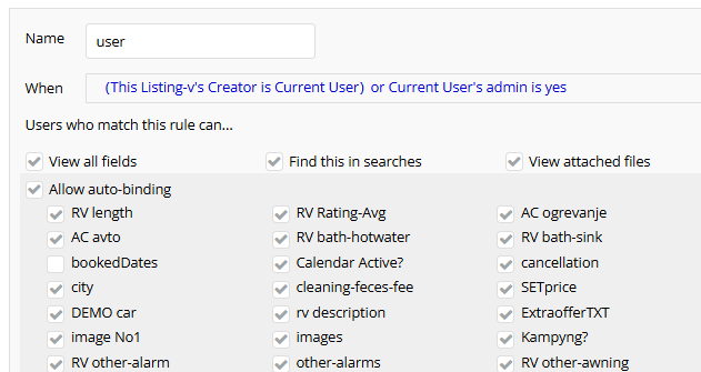

Is it possible you have privacy rules restricting who can auto-bind, and that your mobile device is logged in using a different account than your PC?
What should I look for?
Since it isn’t working even with regular workflows, let’s leave auto-binding aside, since Privacy rules can be involved.
Send screenshots of the log events after you click in the Save button. It would also be helpful to see how you have defined your workflows (what data sources you are getting the data from to be saved) as well as what data is in those data sources at the moment of clicking on Save button.
Here are privacy rules for this data table:
I do not understand what you ment by mobile being logged in under different account than PC?
Of course user that worked with app through mobile had different account than me when on PC. I logg in under usual user account through Pc and same one through mobile. PC stores data, mobile version doesn’t.
Here are user privileges for auto -binding.
I am not sure what workflows have to do with issue. Basically user types data in input field. In both cases auto binding as well as when workflow (save data) is used, same result in case of mobile - not saving data from input filed (Samsung S22)

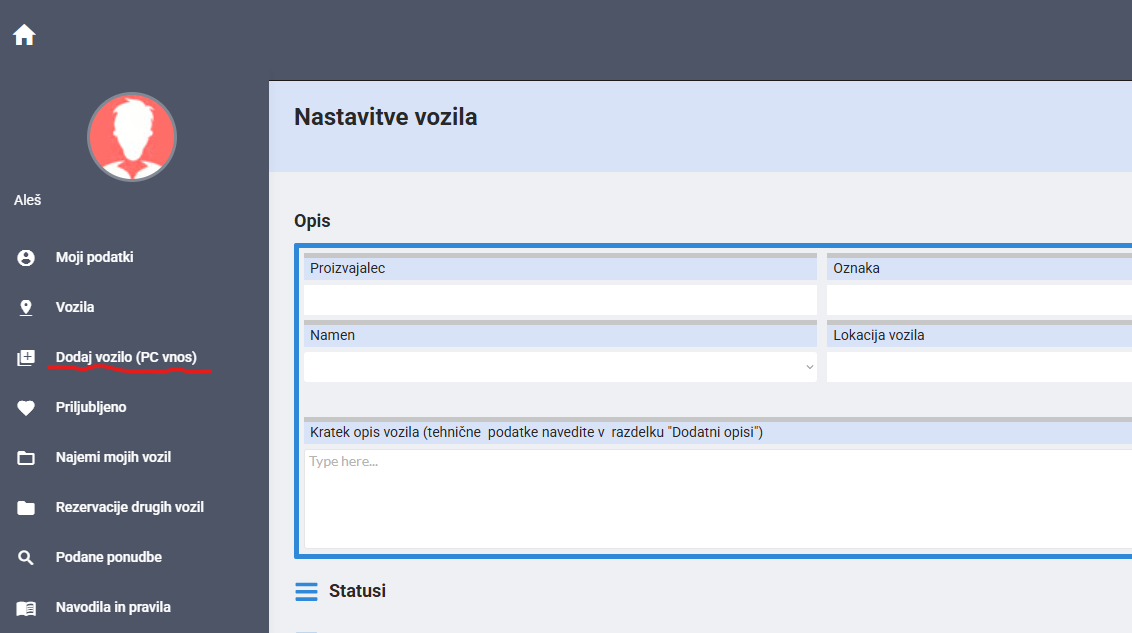

Problems are on page “Nadzorna plošča” (Dashboard) when adding cars “Dodaj vozilo”.
I am not happy with design but I am focusing on the functionality at the moment.
AleĹĄ
I can also edit fileds on existing car and it saves.
I just noticed that in mobile version popup doesn’t show up. On PC popup appears to confirm adding new vehicle. In mobile this doesn’t happen. That’s probably reason why data doesn’t save.
I’d just make sure that popup has responsiveness and dimensions that are compatible with mobile - it’s possible it’s popping up but off screen / hidden behind something else when in mobile.
Quite possible. I am searching where it is on smaller screens.
