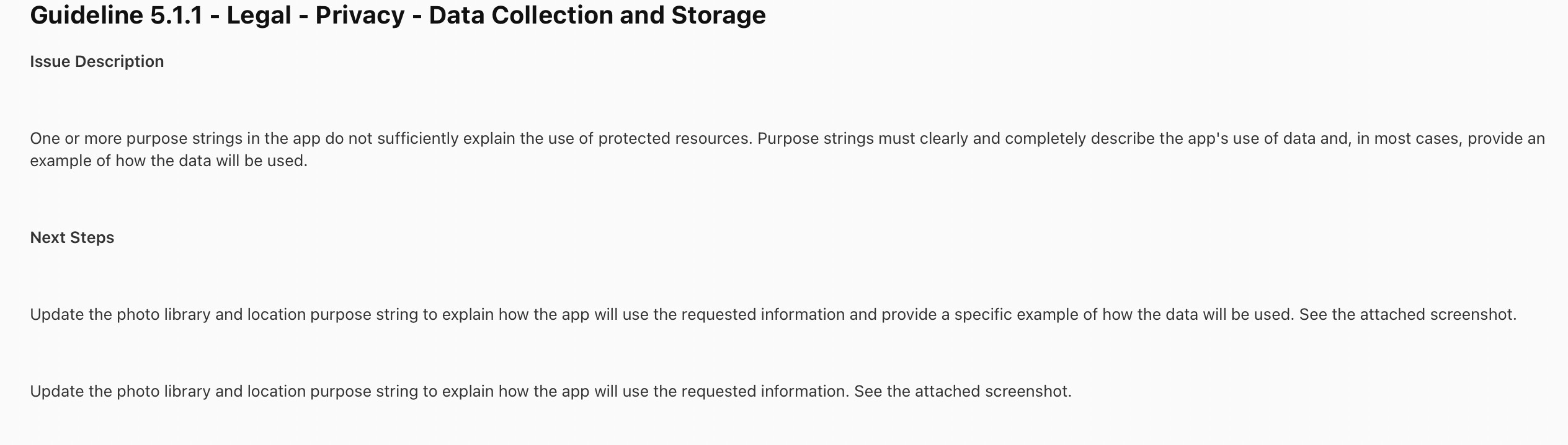

My app was rejected on iOS for the following reasons:
Issue Description
One or more purpose strings in the app do not sufficiently explain the use of protected resources. Purpose strings must clearly and completely describe the app’s use of data and, in most cases, provide an example of how the data will be used.
Next Steps
Update the photo library and location purpose string to explain how the app will use the requested information and provide a specific example of how the data will be used.
Any ideas on next steps? Thanks

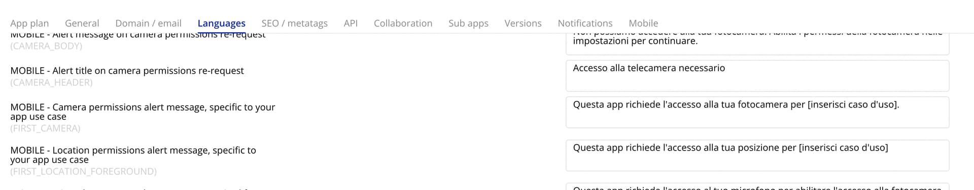

Can you please direct me to where on bubble you can input the purpose text? That would be a big help, thanks!
@nathanbikindou
  • From your bubble app settings, Navigate to Languages
  • Scroll down to “MOBILE - Camera permissions alert message, specific to your app use case”. This I believe that’s the one you need.
Try that and see if it works

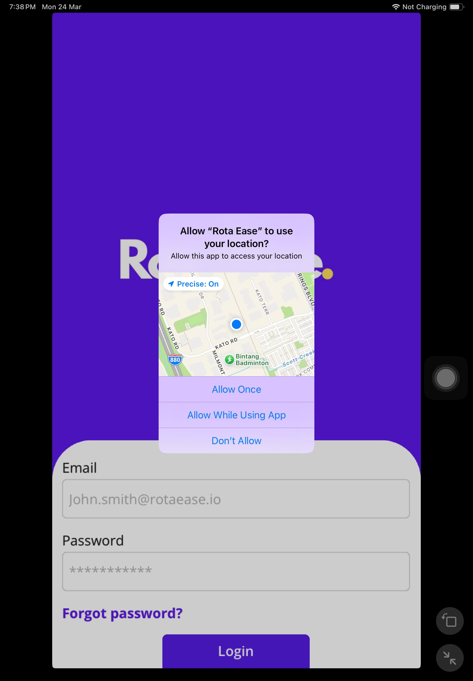

I changed this previously but it was rejected. The text that appears on iOS is “Allow this app to access your photos” & “Allow this app to access your location” not sure where it’s pulling this wording from
Can you better specify the reason for rejection by Apple?
For the attached reason & screenshots as example of what my app is displaying

Is there a reason why the attached purpose text that I inputed from bubble isn’t pulling through?
Did you do a new build after updating the purpose strings, or an OTA?
It was a new build
I also tried with a new build and the texts aren’t using the purpose strings from Languages - MOBILE
