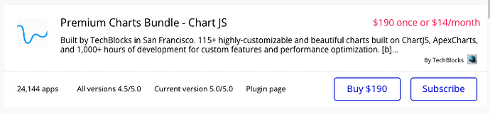

Thanks. Are you referring to this plugin?

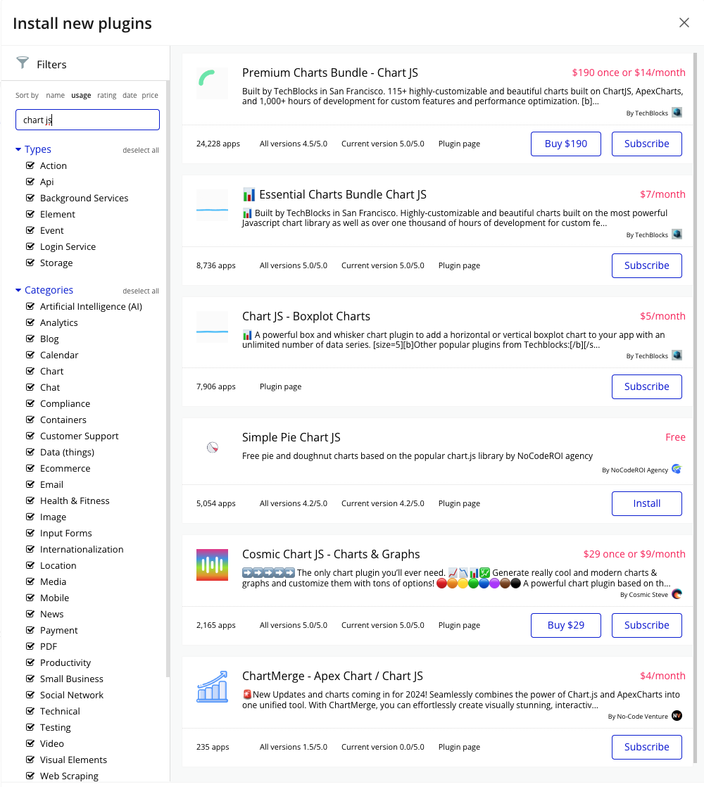

Hi, sorry to chase, I’m sure this should be extremely simple but I am struggling. I used the BOT as you did and it implies that charts.js should be available however I only see the options below? I have tried contacting a person at Bubble however in almost 2 days I have only received a holding message. Any help and guidance here would be greatly appreciated. Thanks!
Yep! The one by Techblocks
