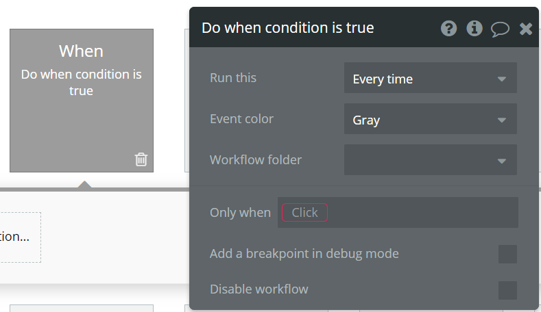

Without diving too deep into this, it sounds like you can accomplish with the “do when a condition is true”
and set it to run every time and then you set the “only when” field to be the rules of what you’ve described above
