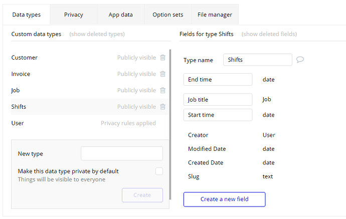

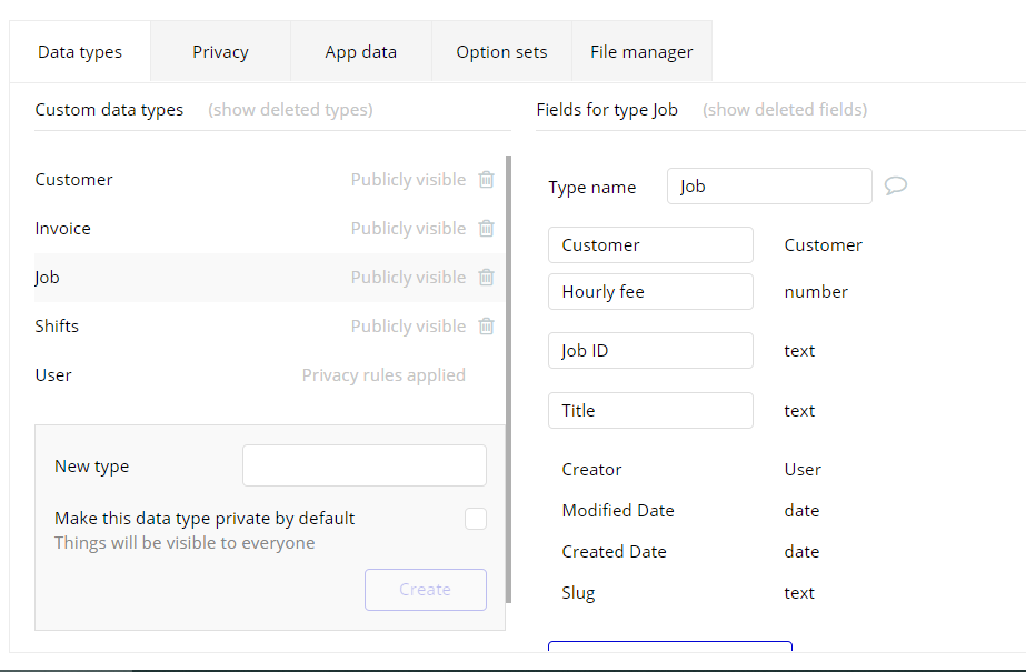

Here’s the database settings for Job
Here’s the database settings for Shifts

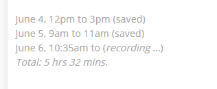

Also, do you think I will need to name the Shifts so I can display them sequentially, as below?
name shifts
The ‘Job title’ field on your ‘Shifts’ datatype is of type ‘Job’, so must be a Job.
In your workflow you’re trying to set it as a text (the Job’s Title) - hence the mismatch error.
You need to select an actual Job for the ‘Job Title’ field, so just remove the last ‘Title’ from the expression.
On a side note, it seems a bit confusing to name your ‘Job’ field ‘Job Title’ when it’s actually a Job (it would confuse me anyway), especially when the Job datatype itself has a field called ‘Title’.
I’d recommend trying to be as logical as possible with your naming conventions as it can definitely help keep things clear when you’re working - the more the expressions read like actual English the easier they are to follow (certainly for me).

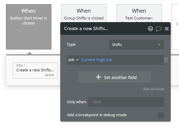

The create a shift page uses data passed from the previous page where the job is set up, so in my workflow for created a shift I have now specifiedJob = Current page job but the DB shows a long string of numbers as the Job title instead of the actual title?

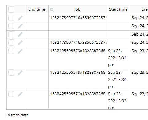

The Job Title (text field)? Or the Job (linked object field)? (maybe post a screenshot to clarify)
Unless you’re setting the Job Title field to be the Job’s unique ID then that shouldn’t be happening.
I suspect you mean that you’re seeing the unique ID of the Job (that’s the default way to display data the DB view) in the Job field of your Shift datatype?.
You can change which field is displayed for a specific datatype in the DB App Data tab by clicking the Primary Fields button in the DB App Data Tab.
The way it’s set up is that a User creates a job which includes a title (that saves correctly to DB) and then they go to a new page to start a ‘timer’ to record the Shift for that job. But, the ‘start timer’ button won’t save the Job title to the DB.
set job
What I see in the DB is this;
Screenshot 2021-09-24 102900
Yeah that’s the Unique ID of the Job.
You can change the specific field shown in the App Data Tab for each Datatype as I said by clicking the Primary Fields Button and setting the primary view field for each datatype (the primary view field is purely for display purposes in your DB tab, and also for exporting data, and has no consequence other than that).
