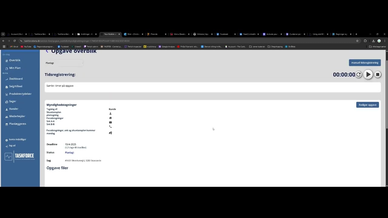

i have this issue when i use better file previewer to display files as miniatures and chose “preview file” as no it jumps and blinks like this.. i have tried everyhting but cant seem to fix this.. can you help out?

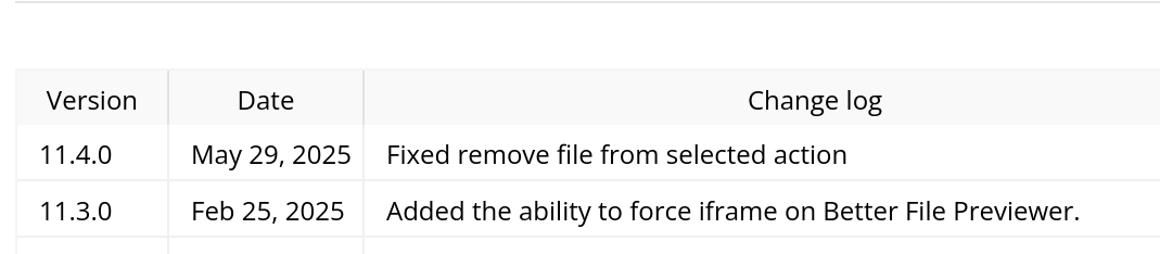

11.4.1 Fixes this :slight_smile:
Awesome! I’m not seeing 11.4.1 yet?
Sorry, there was a small typo. It’s version 1.4.0 :slight_smile:
