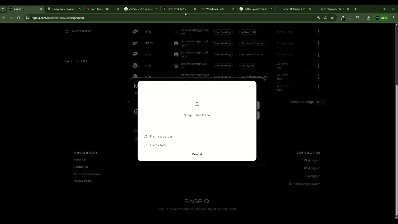

Bloody awesome plugin first of all. One issue I am having is the upload order when I am adding 15ish + photos via drag and drop. It seems to break and add some of the images from the bottom to the top. Heres a video showing that everything works fine when you select the images directly from the browser, but then breaks when you drag and drop them in:
