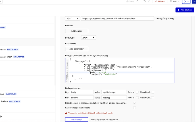

Thanks, but I’m having trouble getting the call to initialize in the API connector. I’m following the example here for the batch send (with template): Templates API | Postmark Developer Documentation
And this is what the call looks like in API connector (using the same shared headers that I use for all my other Postmark transactional calls)
2 ideas here
  • Remove that last comma, the one after the curly bracket and before the square bracket. (ChatGPT can be good at troubleshooting JSON, just copy and paste into the ai and tell if you are getting an error)
  • You may have a different Postmark Server for Broadcasts than your Transactional one, so make sure you are making the call to the correct Server

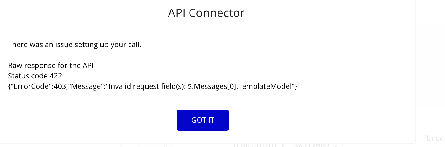

What is the Error Response when you try to initialize the call?
Per the message, the issue is in your Template Model.
Looking closer you do not have the <body> field wrapped in quotations. This is likely the issue. Or there could be another issue with the Template Model not aligning with your Template
