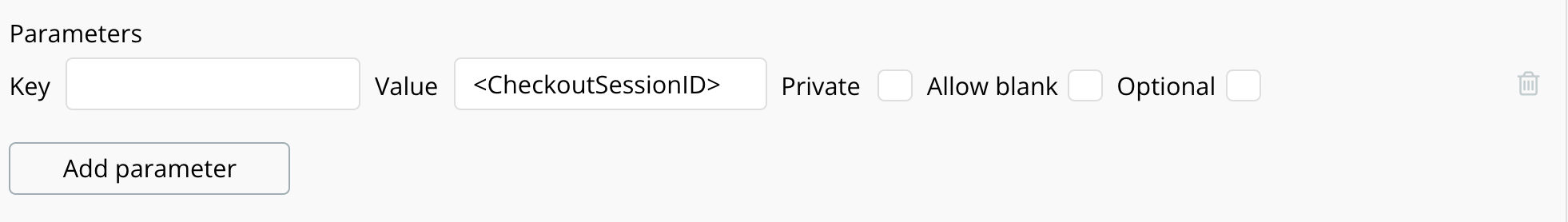

I’m using a newer version of Bubble than I was previously and doing a rewrite of my app. I’m running into a problem.
I’m trying to make a call to the Stripe endpoint at:
https://api.stripe.com/v1/checkout/sessions
This endpoint returns a lot of information about a checkout session after the session is complete. So you can get the name of the person, etc.
I’m sending this parameter, as is instructed by Stripe:
It’s a NULL/empty Key and an ID number for the checkout session. It’s an easy call. It returns all that info about the checkout session after you make it.
Previously, in the Workflow editor in Bubble, it showed up like this:
So an empty Key showed up as param. with nothing next to it. It worked just fine and returned all the info I needed. It also works fine in Postman.
NOW with the newer Bubble version I’m rewriting in, I’m having a problem. When there is an empty key, it looks like this!!
There is no longer a place to enter my value as Bubble thinks an empty key means "don’t show it’
PLEASE NOTE: “Private” is unchecked in the API plugin editor so it’s a public key. It should show up even when empty. That’s how it worked before.
How are people getting around this? How can I have my empty key show up in the workflow editor so I can give it a value for the API call?

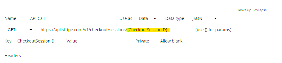

Hi!
The session ID should be passed as a path, not a parameter:
https://api.stripe.com/v1/checkout/sessions/[Chesout Session ID]
Remember to uncheck the Private checkbox so you can pass the session ID as a parameter of the action.
Oooh! This is a good workaround!
I will try it and report back. So the “” will make it visible in the workflow editor?
Will try and report back ASAP. Thank you!!!
FLAWLESS! Works perfectly! Thank you!!
