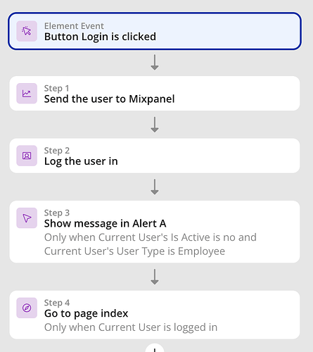

Can you share more details about your login workflow?
Nothing too crazy in there, I don’t think. Based on some revised output of error text, I think it’s actually submitting before the password is filled (but again, not a problem on any other sites… so it has to be a bubble something).

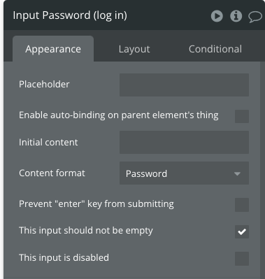

  1. Make sure you are using the correct content format for the inputs. For example, make sure the password input is content type password. This helps the 1Password extension to know what fields need filled.
  1. I would move the “Send the user to Mixpanel” step to after the user is logged in. There could be some latency with the additional network call.

Confirmed that the fields are of the correct type, and moved the MixPanel event to the end of the workflow. No change to the behavior.
But then I ALSO went ahead and checked the input should not be empty box because you had it checked on your screenshot… and of course that shouldn’t be empty… And THAT solved the issue.
Thank you!
