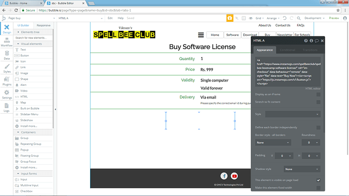

Hi Guys,
I don’t know what else to do but post here. I’ve filed a bug report because a HTML element (the BUY button!) is not showing correctly in one of my projects but showing correctly in another. I don’t want to embed it in an iFrame, as the user experience is totally different for this checkout button, and the popup looks terrible. Here is the problem:
a) HTML element details for the new project, where i pasted the EXACT same HTML element from my old project:
 ![new%20project%20-%20html%20element%20design](https://us1.discourse-cdn.com/bubble/original/3X/3/3/335d8f485b62cf3ecf9eb612a8dd38f4caf61697.png)
b) HTML element shows correctly for the new project:
 ![new%20project%20-%20html%20element%20-%20showing%20correctly](https://us1.discourse-cdn.com/bubble/original/3X/b/6/b64a17ea719baae50b62d7d37c4221ab3344e6d5.png)
c) HTML element details for the old project
 ![old%20project%20-%20html%20element%20design](https://us1.discourse-cdn.com/bubble/original/3X/7/6/7672e236954a530d9533caf2fe22a79c993271a1.png)
d) HTML element not showing for the old project:
 ![old%20project%20-%20html%20element%20NOT%20showing](https://us1.discourse-cdn.com/bubble/original/3X/1/b/1bf54eb152902ba7291b7c293428bff832f2ee79.png)

Hello,
Emmanuel here, founder. I’m glad you’re reporting this here as it gives me the opportunity the talk about solving issues when users use external code. We do our best to see if there is something we can do when users use custom HTML, but as this is not code written by us, there are limits to what we can do. In this case, we have tried on other apps and didn’t get the element to display, which makes us think there is a change with the code you are using.
For the HTML element, what we do is very simple. We basically inject the HTML in the div, as described [here](http://api.jquery.com/html/#html2). If you check the iframe box, we inject it in an iframe.
This behavior has been like this for years, so if you see a change, maybe the code of the provider (or your custom code, I don’t know) has changed? I would recommend reaching out to the provider with an example page and ask them why their code is not rendering in this situation.
We do our best to help with custom code, but I hope you understand that this is a little bit out of the scope of support. Having said that, if you can share a page where it works, we can look again, your report didn’t provide this.

This is not working here as well, which i think shows the script have an issue. Did you reach out to the provider with this page?

At a guess, it isn’t playing nicely with some other element on the page.
For me 1) Doesn’t show on standard Chrome. 2) Does show on Incognito Chrome 3) Shows on Edge 4) Doesn’t show on Firefox !

Wow that’s so strange. Thanks for the help, Nigel ! Would never have guessed that it was behaving so differently across browsers.
