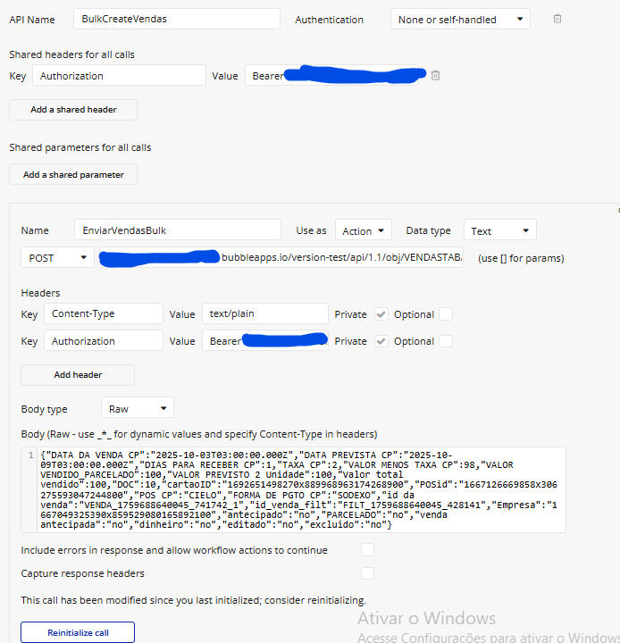

I run an app that inserts batches of records into a data type via the Bulk Create endpoint (API Connector). Each bulk call inserts about 10 records at once. Each record references other Things (we’ll call them components/parts) and also contains several numeric and text fields.
The request format is text/plain with multiple JSON objects separated by newline characters, per Bubble’s Bulk Create requirements.

Thank you for offering to help — I’m sharing a example of the JSON I use for the Bulk Create API call.
It always fails on the field “FORMA DE PGTO CP”, but the specific card (cartaoID) that fails changes every time. That’s why I believe the issue is not in the JSON itself, but possibly in how Bubble processes relationships during Bulk Create.
In this example, 9 records are created correctly, and 1 fails. The JSON below is exactly the same used for all tests (same photo, same data). Sometimes the failing card is “Visa Débito”, other times “MasterCard”, etc.
Could you please check if there’s anything in this JSON format that could cause that kind of inconsistent behavior?

Hi!
Thanks a lot for your help and previous replies.
In my case, the related data (such as card and POS) already exist before the bulk creation — the issue is that when I try to create the sales that reference these items, one record always loses its relationship (for example, the cartaoID field ends up empty).
We’ve tested every possible approach, including:
  1. API Connector (Bulk Create)
    • Configured with Content-Type: text/plain
    • RAW body (one JSON per line, no brackets)
    • Tested with 3, 5, 10, and 20 records
    • Still, 1 out of every 10 loses the relationship (usually the first one in the batch)
  2. Straight quotes and JSON formatting
    • Fixed all curly quotes and validated with JSONLint :white_check_mark:
  3. Cache warming
    • Performed GET requests to cartao and POS before sending the bulk data :white_check_mark:
  4. Sequential / chunked sending
    • Tried splitting JSON into groups of 3 or 5 and adding delays between requests :white_check_mark:
    • Same issue persists
  5. Backend workflows and JsonToBubble
    • Tried using the JsonToBubble plugin and also Schedule API Workflow on a List :white_check_mark:
    • Also tested backend workflows to avoid parallel processing :white_check_mark:
  6. Front-end HTML (JSON calculator)
    • Tried sending directly with fetch() (blocked by permission)
    • Returned to using the API Connector
The only method that worked for a while was the split by approach — creating each sale one by one.
It worked perfectly at first but eventually broke and proved too fragile and unreliable for mass use.
So, the only method that still works is via API Connector, but with it, one record out of every ten fails, apparently due to parallel processing or cache not being ready in time.
Do you happen to have a working example (even a simple one) showing how you successfully perform bulk creation of related data without losing the relationships?
That could really help us understand what’s missing.
Thanks so much for your time and support! :folded_hands:
