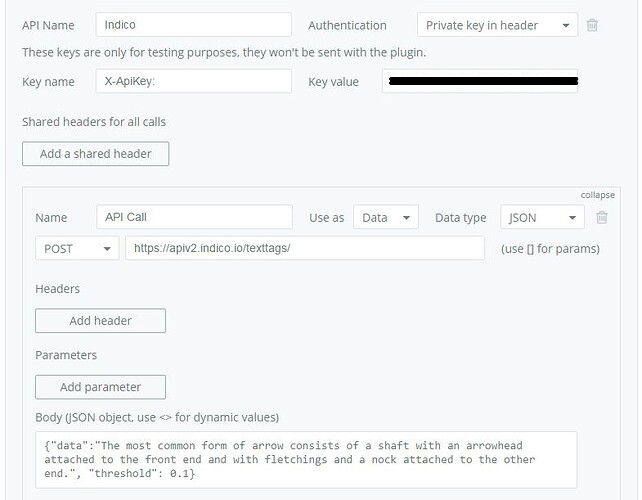

I get this error
when I try and initalize this
It is all just sample data from Indico’s API docs at Client Library Docs – Indico Data
An ideas or help would be appreciated, even if it just was just what to search for and study. I’m not even sure if the error I am getting is from Bubble or from Indico.
What would happen if you took the colon out after ApiKey?
The API is not returning an error, so I would use Postman and try and connect it, then bring it into bubble.
Another possibility is rename it to api-key, as per their javascript examples.
That did it! I’m downloading a copy of postman too, it looks like a good, well documented way to test things. Thanks
