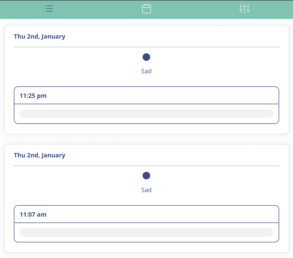

I have built an iOS journal app. I’ve included end to end encryption so that the journal entries remain private to the user. As part of my app I have a list view of all entries that a user has uploaded (see screenshot).

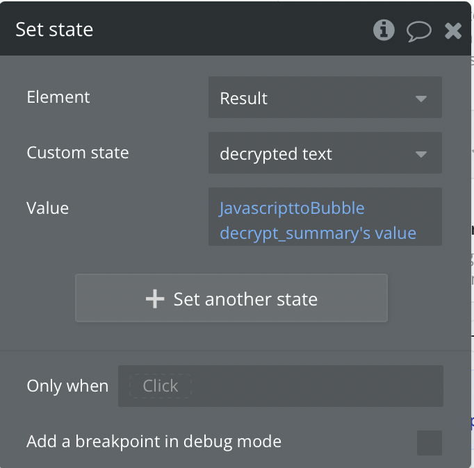

I’m trying to set the output as a state on an element using this:

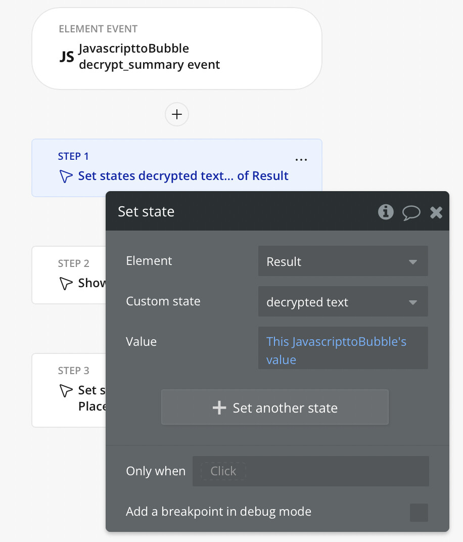

I’ve tried checking the “Trigger event” box and then created this workflow - is that what you meant? This still doesn’t work - the workflow isn’t being triggered.
yes @drmattcrooks this is what I mean

I’ve tried both of those and still nothing. I added a console log after the bubble_fn_decrypt_summary and it appears in the logs. In the screenshot of the workflow above it hides the grey horizontal bar (shown in the previous screenshot of the app) and displays the text value from the bubble_fn_decrypt_summary instead - this isn’t happening which is why I don’t think the workflow is being triggered by the javascripttoBubble event.
