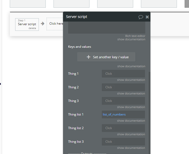

Here’s a list.
And I’m scheduling a backend workflow and passing in that list
Passing the list to my server script
But it’s not there
Am I doing something wrong. I’m having no trouble doing this exact same thing on the front end, but on the backend it’s not working for me.

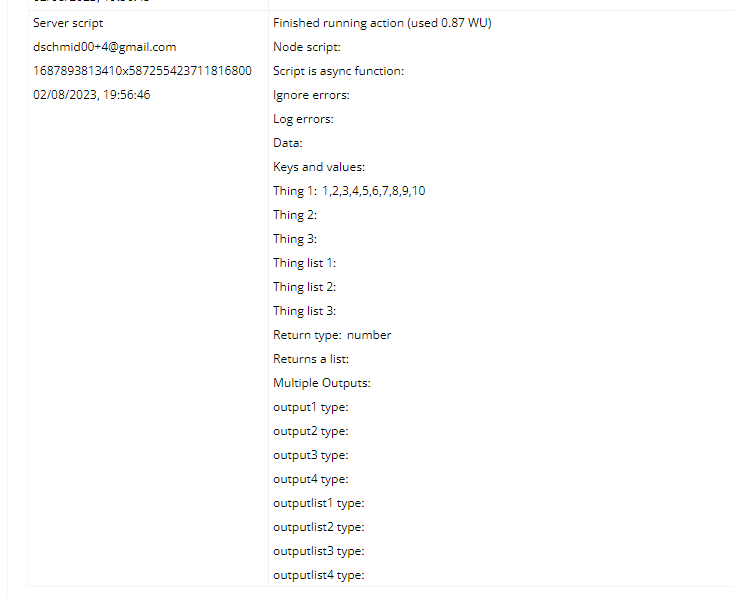

here’s the list in server logs
I can get single properties (Thing 1, Thing 2, etc) in there no problem.

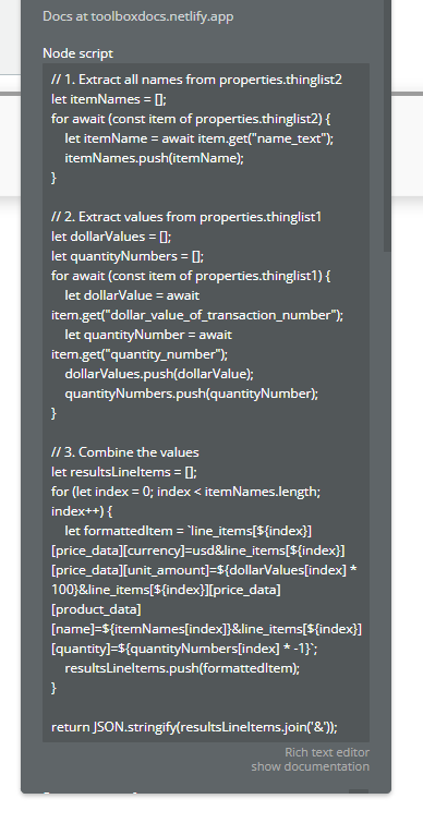

I’ve added some examples here: example editor page
The examples wrap the result in JSON.stringify because the output is put onto a text group.
// list of numbers in thinglist1
// list of numbers does not have listProperties
var len = properties.thinglist1.length();
var result = [];
for await (const item of properties.thinglist1) {
  result.push(item);
return (result); // result is array of numbers
// list of books in thinglist1
var len = await properties.thinglist1.length();
var result = [];
  // result.push(item.listProperties());
  result.push(await item.get("title_text"));
return (result); // result is an array of titles
The docs did not cover this adequately, I’ll update them.

Thanks it work. Really appreciate the help and the additional examples. :slight_smile: Only thing is the list input is not visible as an input in my server logs.

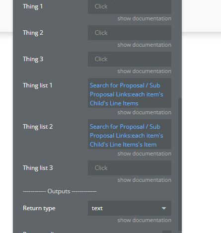

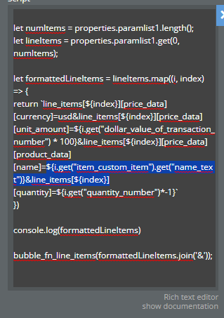

Something else that would be amazing if you could include it in the docs is how to access properties on nested objects.
on the front end I could chain .get() to go into another object and then get the field I cared about.
On the backend, no amount of await seemed to make this possible and I had to put two lists in and do this.
I’m sure there’s a way to do it in one, but after trying for a couple hours I took the easy way out.

I’ve updated the docs, added another example to the section params-bubble
(The cached time on the docs CDN is kinda long, to refresh the page cache: open the site, turn off network, refresh page to get error, turn on network, refresh page and should be the new one not the cached one)
I also added another workflow “list of books categories” in example app editor
var result = [];
    var cat = await item.get("category_custom_category");
    // result.push(cat.listProperties());
    var catname = await cat.get("name_text");
    result.push(catname);
return result; // list of text
I hope this proves useful! :slight_smile:
