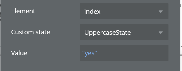

Not sure how I would filter the data source. I currently set a state value for Upper Case to yes, and a state value for Lower Case to yes at Page Load. And then when the slides are set to No or Yes, I set the same states to yes or no to enable/disable the cell value being displayed or not.

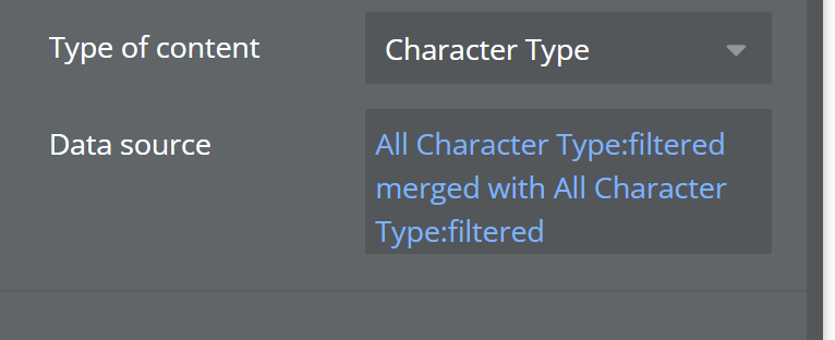

I set up my data source to be

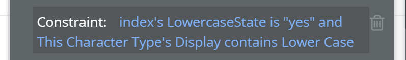

My filter criteria is:
But when I preview, all I get is the last criteria
The dropdown should show both Lower Case and Upper Case.

The merged with operator should do the trick… not sure why it’s not working for you. If you are trying to use an advanced filter (and I’m guessing you know the filtering takes place on the client side), you will find the Advanced option at the very bottom of the dropdown when you add a constraint to the :filtered operator.
