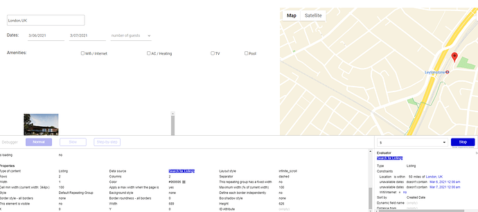

Also when in search and i click wifi/internet yes, the search results change
but if i uncheck - search results don’t change back!

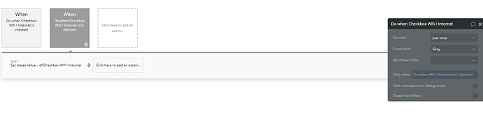

Instead of using a Do when condition, you should use, Input value has changed to trigger your workflow. In the condition, just use the same that you already have (Is checked, Isn’t checked)
where do i find this please

It doesn’t seem to work

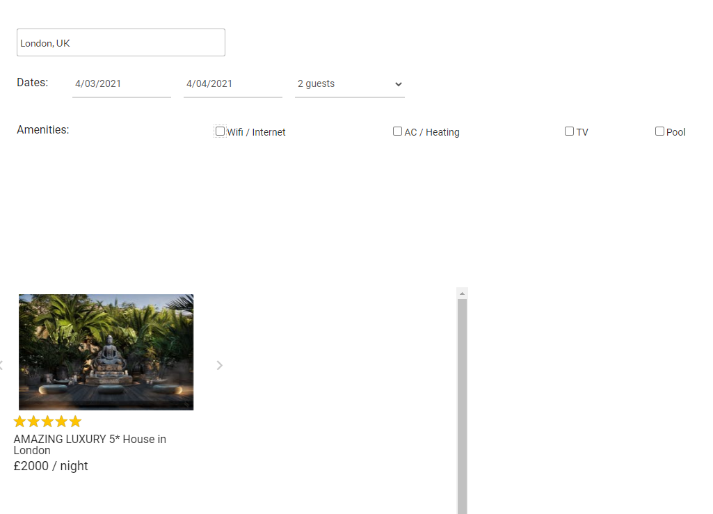

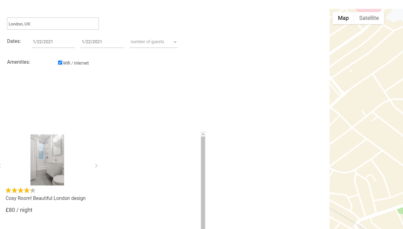

here is the search page you can try march for example, london - and it doesn’t show anything when box unchecked or when checked and unchecked, shows only 1 propety
Try to select “Ignore empty constraints”
Also, be sure that other filter you have is not the reason why you are not getting more results.

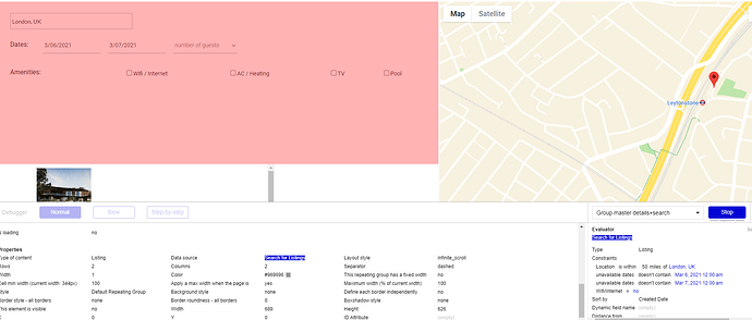

it works at first when you didn’t input checkbox’s value, but if you check and then uncheck internet, it stops working and only shows one search which doesn’t have wifi (but it should show all listings with and without wifi)

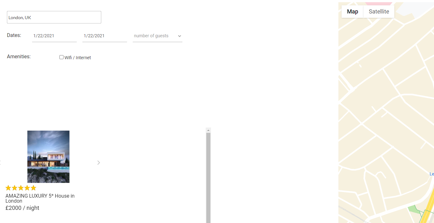

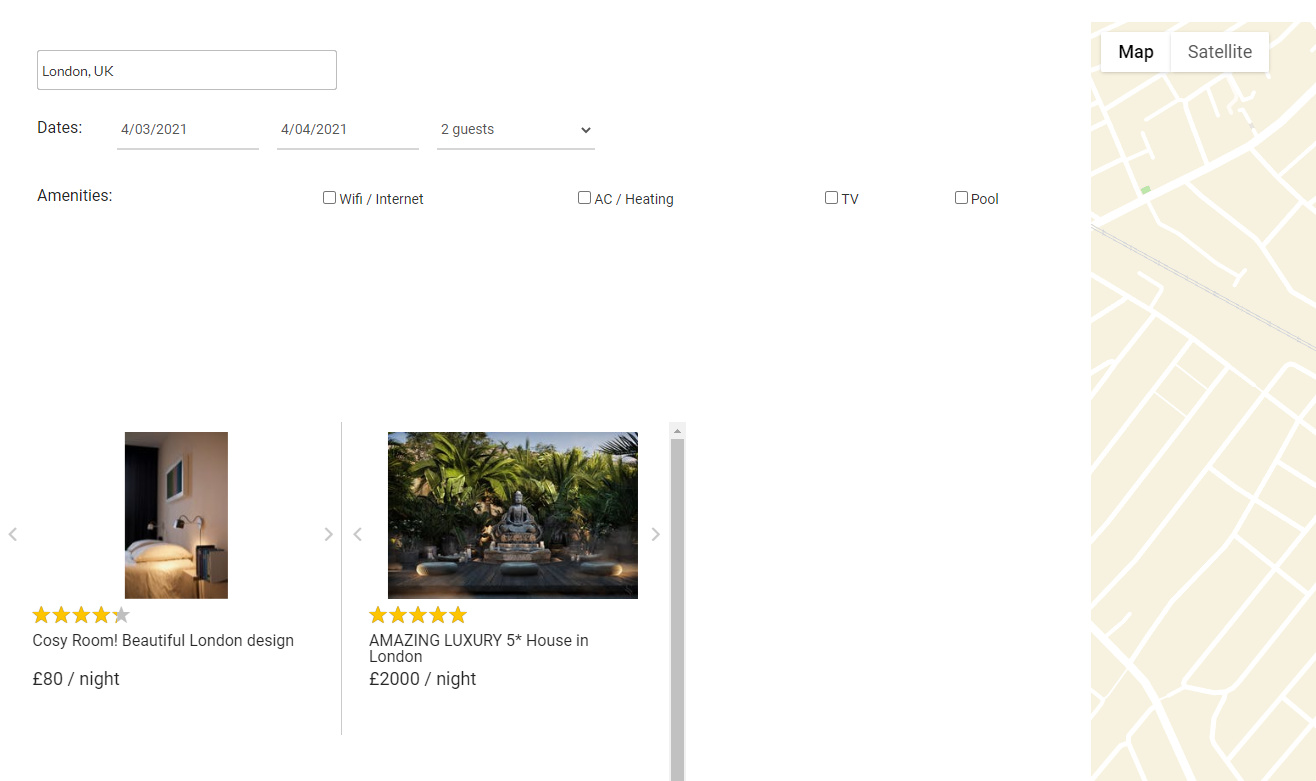

both unchecked and shows both results (before you start clicking checboxes)

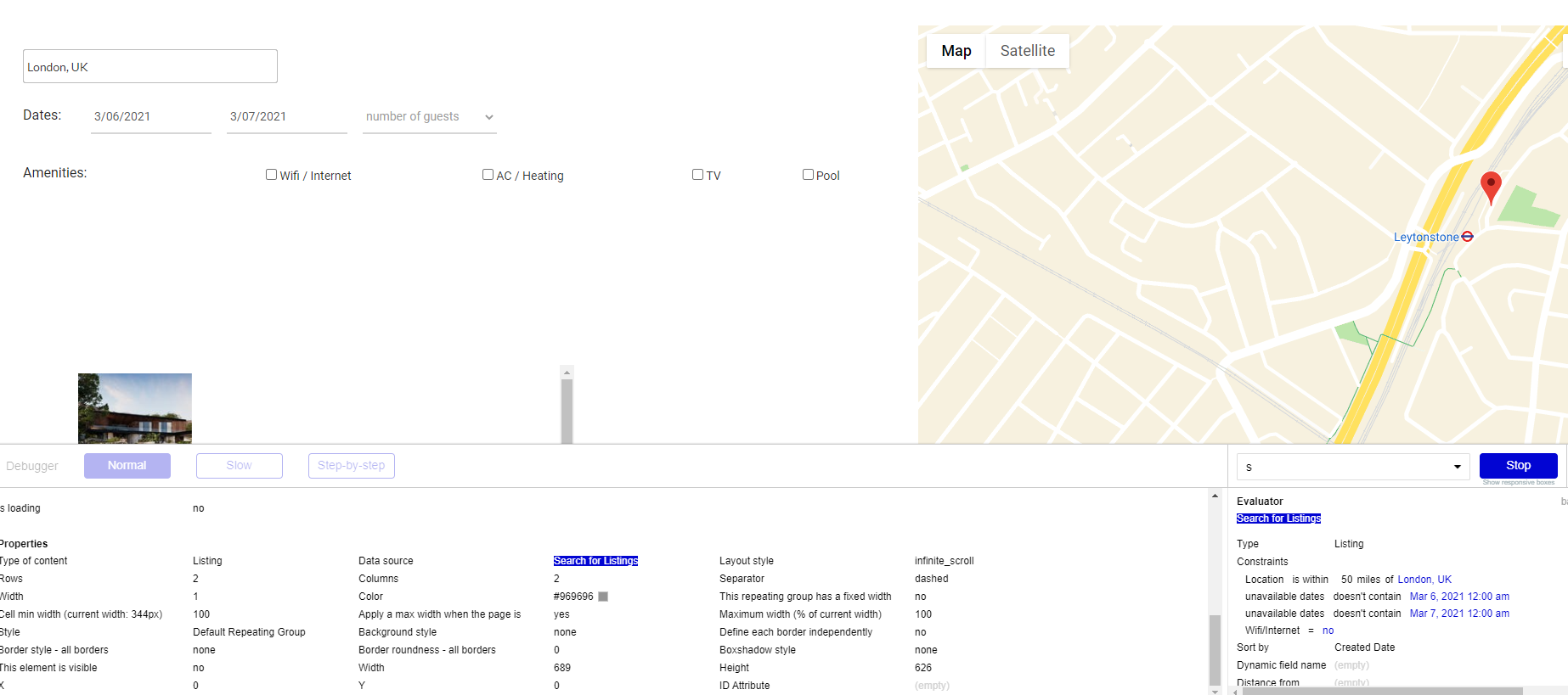

second photo - results when checking and unchecking

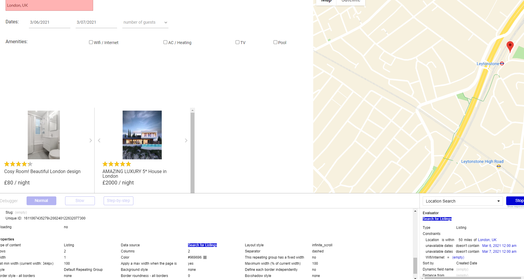

Inspect in debug mode the RG value and filter. It may help you find what is causing this

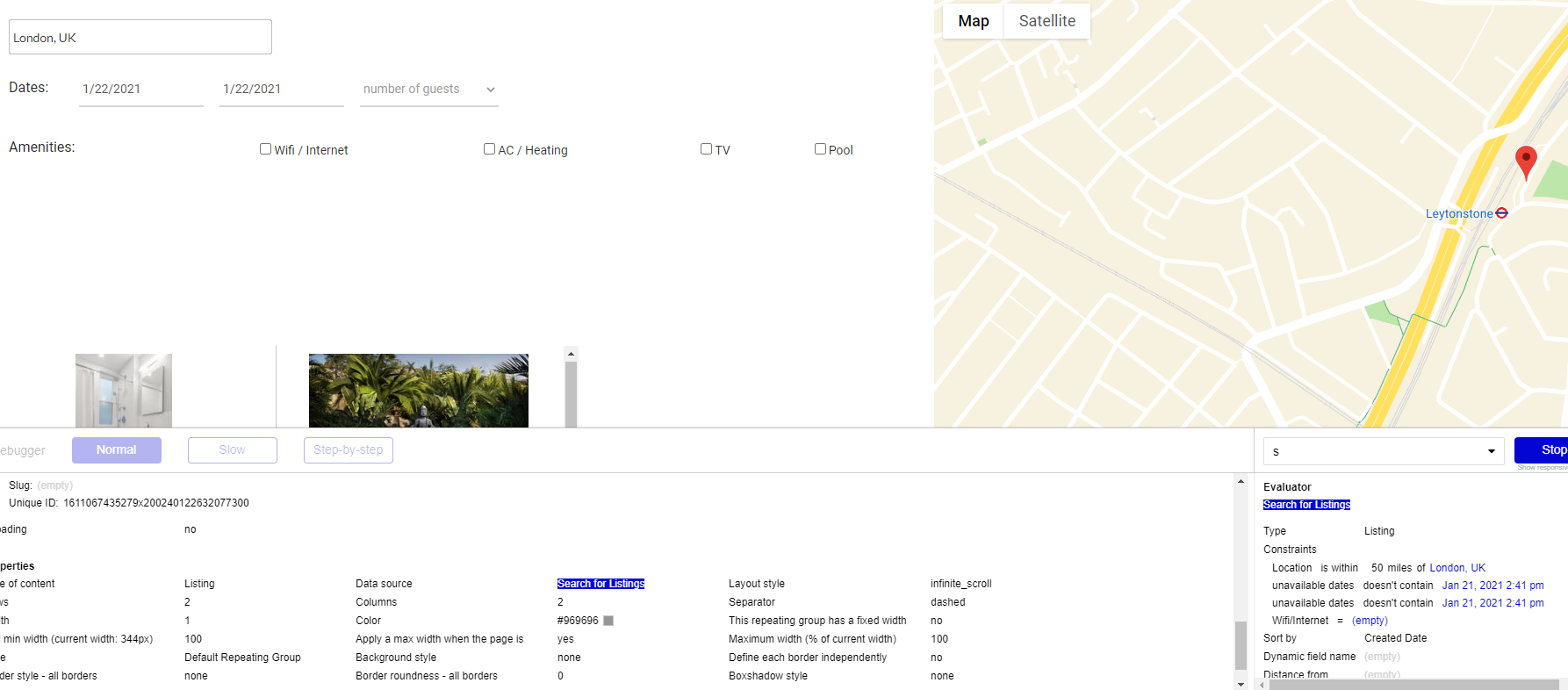

so when value is empty, it shows all listings with wifi and without
but when checkeding and unchecking the box, value becomes no and it shows only one listing
I am not sure what to do about it as search should be showing the value of the box as empty ? when empty and not no? and show all listings
It’s hard to compare because your screenshot doesn’t have the same date in filters.
Also,
you can set default value of checkbox to false (or true depending of what you want).
when empty
when no
