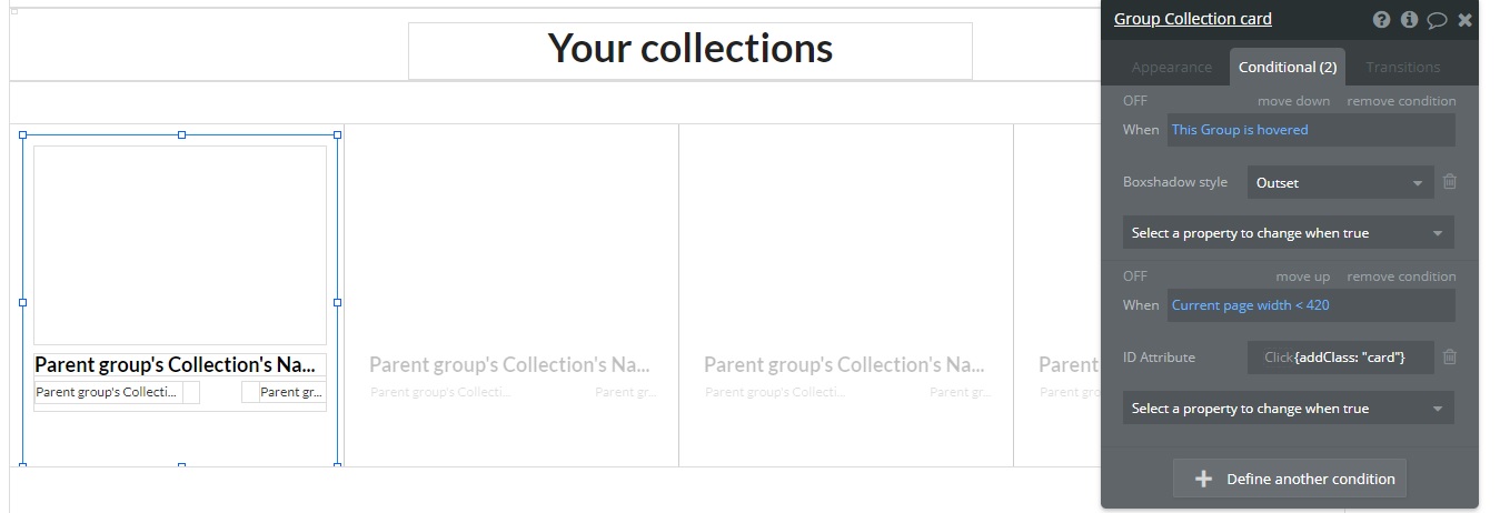

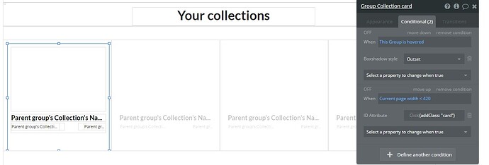

I tried using this in my app to implement responsive height. I am running into issues because of divs called bubble-r-box which bubble auto-creates while rendering the page. While the classes I am adding reduce the height and width of the element, the bubble-r-boxes remain at a larger height and push elements away from the desired position.
I am trying to show cards having a cover image and some textual details inside a repeating group.
The editor view is:
I have applied the following classes in order to make the elements responsive:
As you can see from the screenshot below, the classes get applied:
But the bubble-r-box screws things up :frowning:
Any idea how to get rid of this and position the elements the way I actually desire? Any help would be much appreciated since in the absence of a true responsive height solution I would be forced to make separate mobile pages and that is no solution at all :frowning:
Regards
Akhil
hey @akhilpuri2003, I’ve hit the same problem a few times and it’s a bit frustrating. The things is that the bubble-r-box elements are contained in bubble-r-line divs. And probably that this bubble-r-line element is in a parent group which is also in a bubble-r-box in a bubble-r-line. So even if you change the size of the immediate bubble-r-box your design will remain broken but just one level upper in the HTML structure.

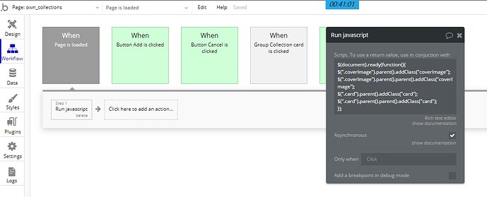

Hey @julienallard1,
Nevermind- I managed to play around and figure it out thanks to you and @w.fly’s answer on Collapsing Buttons Horizontally.
I ended up using jquery to target the bubble-r-box and its parent and add the same classes with responsive height and width to them. The rest fell in place on its own. Thanks for your help. I am pasting the updated screenshots for anyone else who might be facing a similar issue. I used the toolbox plugin to run the javascript in my workflow.
This now gives me great hope that I should be able to maintain only one version of the site instead of having a separate mobile page, which would have become a major hassle over time.
