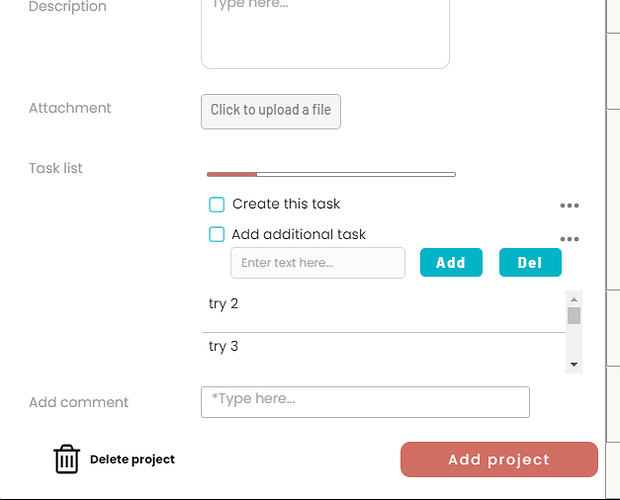

this is mine

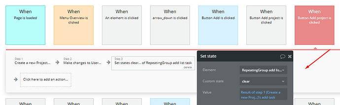

this is my ‘set state’ workflow
my RG call ‘add task list’ which i set custom state named ‘clear’ with ‘text’ type,
and my workflow for set state like picture

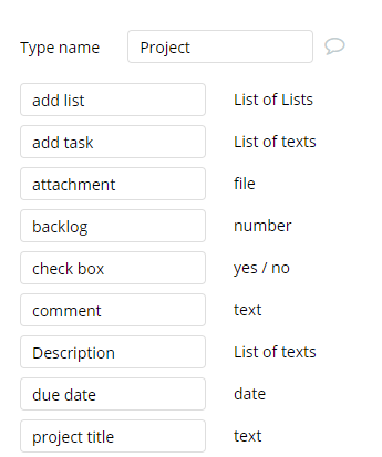

What fields are in the data type “projects”?
Which fields are in which type?

  1. here’s my project database
    11
12

  1. Let’s create a project with “When page is loded”.
  2. set the data type of the page to project and the data source to the project created in step 1. You can probably do this with set state.
  3. “add task button” or “dell task button” should be something that changes the “add task” of the project on the page.
  4. when you click “add project”, you will see
workflow1 make to change current page’s project
workflow2 create new project
workflow3 set state page result2’s project
when input isn’t empty (attention)
  1. Set the RG data source to current page’s projects
