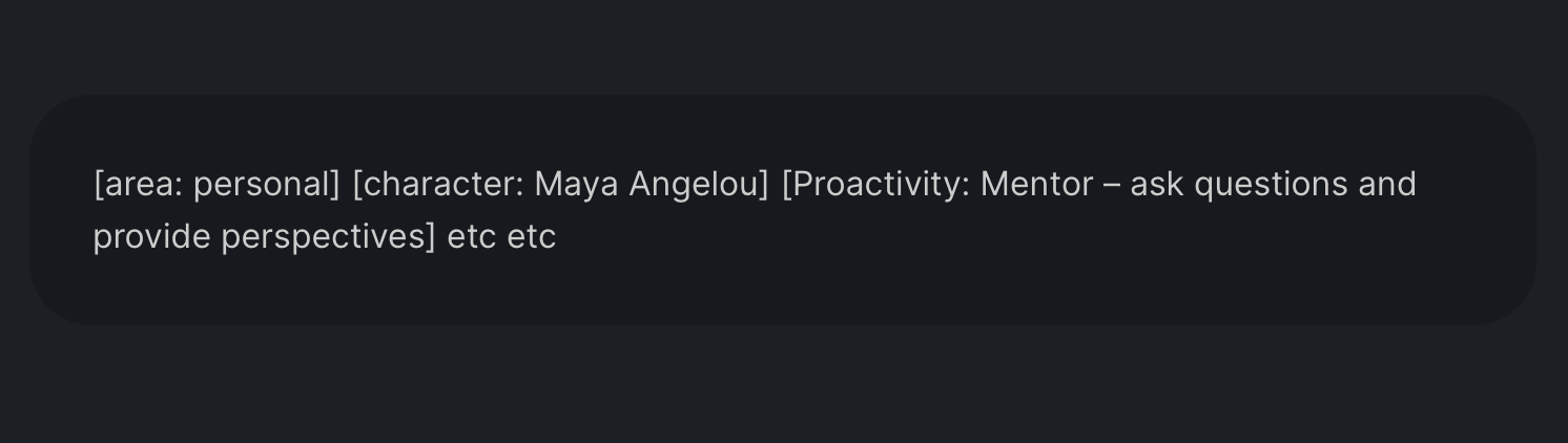

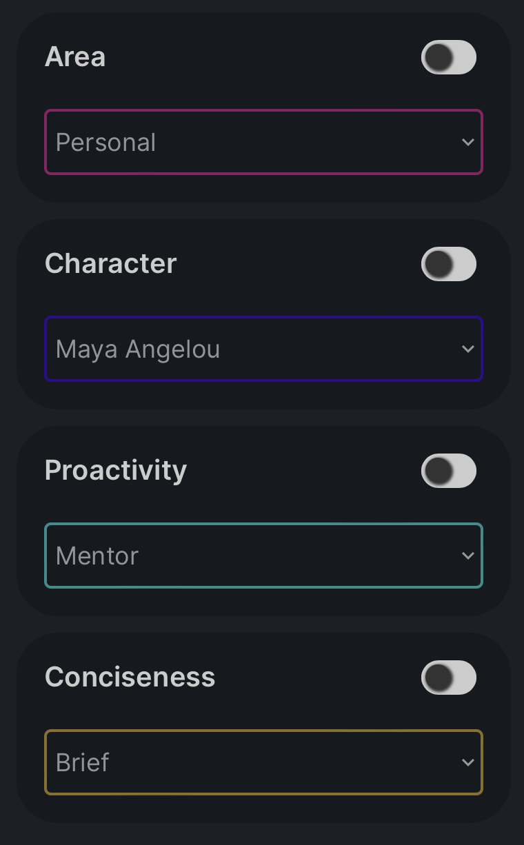

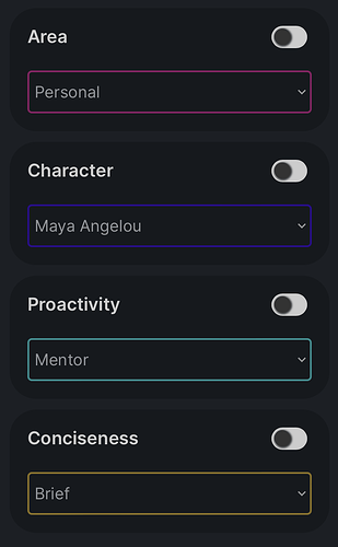

Was just about to, see provided. Only show the values selected from the dropdowns. For instance, “Proactivity” dropdown value “Mentor” generates “[Proactivity: Mentor – ask questions and provide perspectives]” (sidenote: actually including the square brackets). In the example, the toggle for “Conciseness” is untoggled, which excludes that option from the generated text.
I can all but guarantee that what you want to do is possible, but I still don’t really understand it. Why are Area and Character showing a value in the text field when nothing has been selected in those dropdowns? And where does “ask questions and provide perspectives” come from when “Mentor” is selected from the Proactivity dropdown?
Appreciate your effort. I took the screenshot at different times, have updated it now to reduce ambiguity. So the text will be generated based on the dropdown as shown now. As for the “ask questions…” that should be an entry in the database mapped to the dropdown value, that the text fields collects. At least that’s my hypothesis.

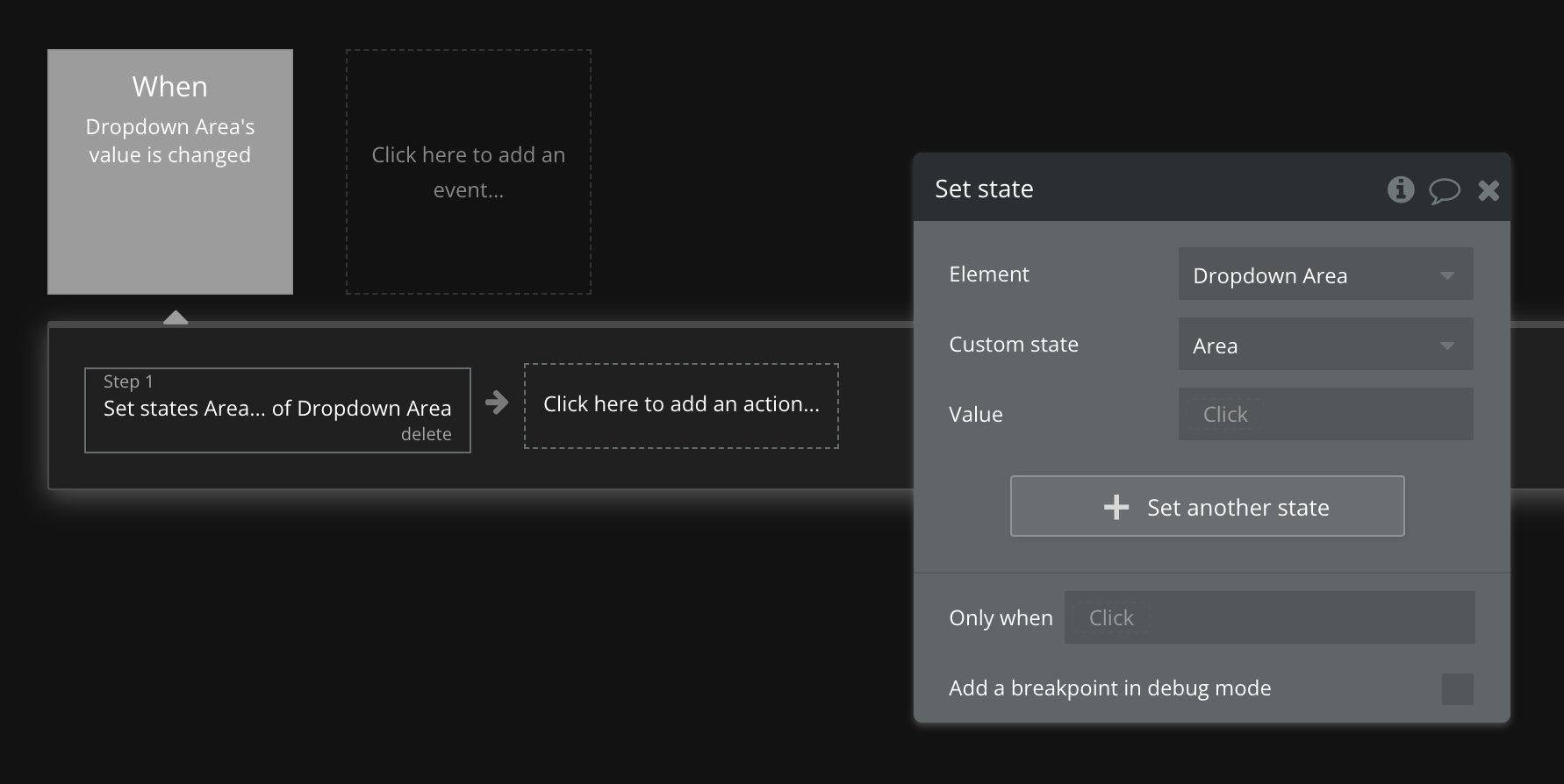

Thanks. You lost me at 4, see screenshot. Not following exactly, the options don’t seem available to me. Can’t find or understand what you mean by “make the state”. What’s the exact workflow and instructions here to make it work?
That’s awesome. I’ve built the dropdowns by referring to a regular database, so I’d have to change it to option sets. I also want to future-proof the setup by allowing users to add their own inputs later on, which excludes option sets as an option for now.
Click the “Click” area to the right of “Value”.
If the data you’re searching through is an option set, then you can select “All Areas”. This will give you a list of areas. Then you’d want to subtract the areas you don’t want to be in that list.
If the data you’re searching through is no an option set, then you’ll need to do a “do search for” as laid out above.

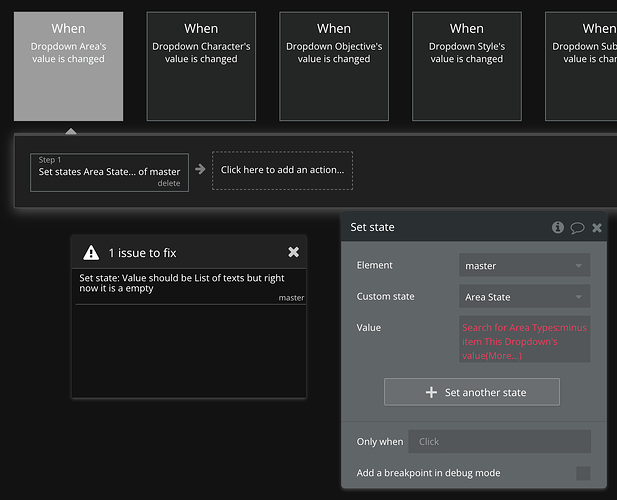

That made it clearer. Still not generating results. It’s not an option set so I’m going for the original suggestion with “do search”. But I get an error when I try entering the value, not sure where the problem is.
Some additional questions to help me understand the logic:
  • Are you saying I should create a new state in the workflow, aside from the one already created -steps 1-3?
  • Why save 1-3 as a list?
  • What does the “:minus” accomplish?

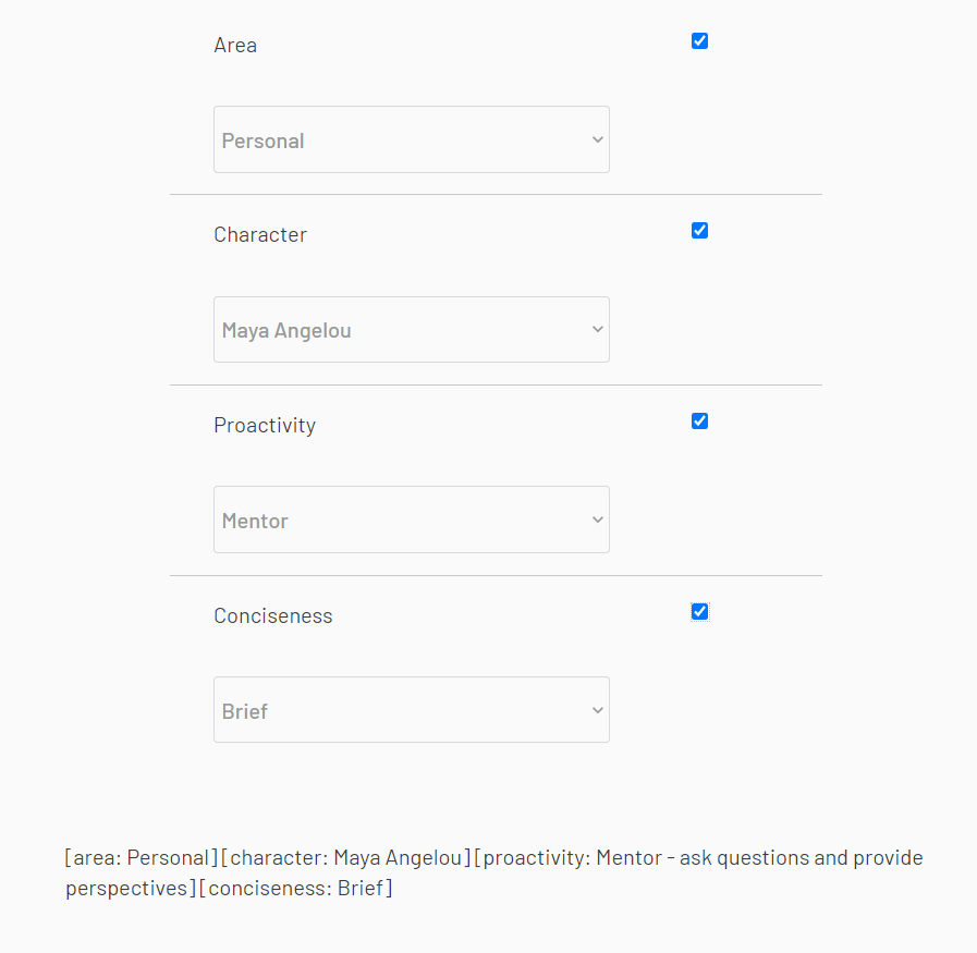

is this what you are trying to achieve? if yes, then it requires several workflows for each toggle and dropdown to make it work since each toggle can add/remove a value and each dropdown can add or change the existing value. Here’s the editor link if you’d like to see the workflows.
The custom state should be a list to be able to show/hide items if the toggle is OFF.
Though this method is not practical or scalable since it requires 5 workflows per dropdown :expressionless: but I guess it’s one way to do it?
