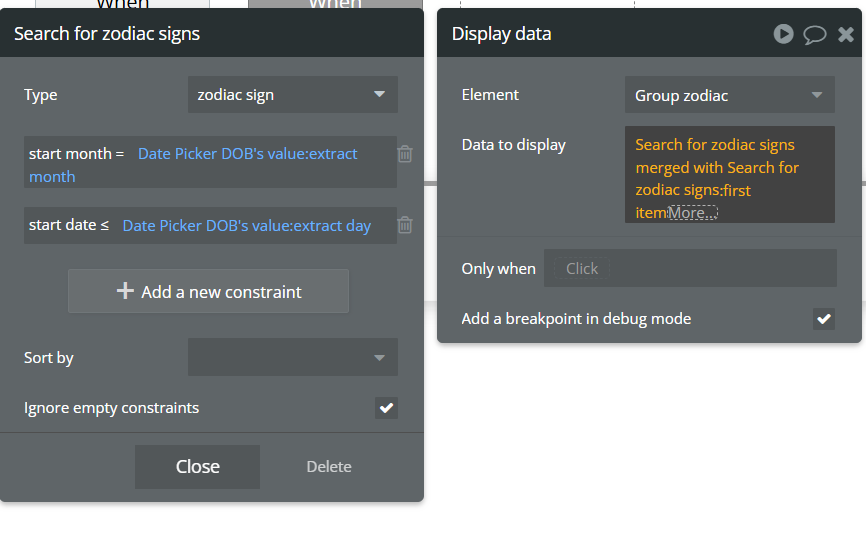

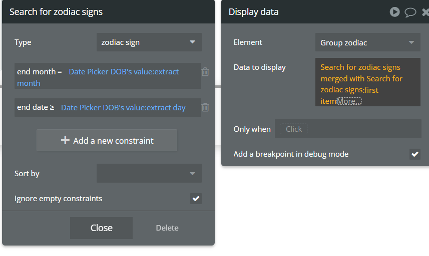

example - scorpio starts on 23rd oct and ends on 21st nov. My db has fields for start month = 10, start date = 23, end month = 11, end date = 21 for scorpio.
so if a person enters his date of birth as 31st oct YYYY, my query should check the date 10/31 against my db using the logic above , which is if the start month field matches 10 then check date >=23 . Now the second constraint which I have pud for second search is if the month is 11 .. I am unable to combine these 2 using “Merged with”. I have tried using single constriant but unable to do so since I dont have “or” or “and” to select in the option.
My final search line is - (Search for Zodiac Signs (Start Boundary) :merged with Search for Zodiac Signs (End Boundary)) :first item

Does this mean that you are getting an expression error? That you are getting an incorrect Zodiac Sign record? Or that you are not getting any record as a result?
I am getting output, but the search logic seems to be not working, all dates in October are coming to be Libra, All dates in nov come to scorpio and so on.
Please send screenshots of Queries 1 and 2
Adrian,
Here are the screenshots:
Search query 1 :
Search Query 2
The problem is :extract day operator is misleading. It does not extract the day of the month, but the day of the week, i.e. a Monday would be ‘1’, Wedenesday ‘3’ and so on, as stated in the docs

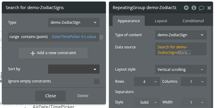

So you need an alternative approach. I’d define a new field for Zodiac Sign of type date range to account for the dates they span. Then I’d use the contains (point) operator to verify if the selected date is within range.
@petter the contains (point) operator might need a name update in the docs, as it appears as contains.
I will try this and let you know, thankyou
@petter the contains (point) operator might need a name update in the docs, as it appears as contains .
Thanks for pointing that out @ademiguel! Now updated :+1:
