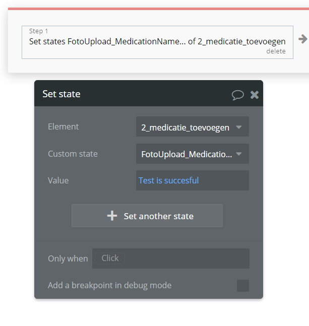

I created the custom state:
Then I also used the ‘set state’ workflow:
But then the custom state option on not showing up in my search box when I want to put it as ‘Default Value’.
I tried by creating both a custom state for the page level (~‘grand parent group’) and for the direct group (= parent group). Any idea what is going wrong?
Thanks a lot, Thomas
Hey @thomas.bol
The problem is in that last image, selecting the state.
In bubble it doesn’t really matter where you put the state, it’s always accessible from any element.
Instead of Parent group's medicatie clear it out and try something like 2_medicatie_toevoegen's FotoUpload_Medication
Works now!! Super, thanks a ton Kayami, your input was very helpful.
