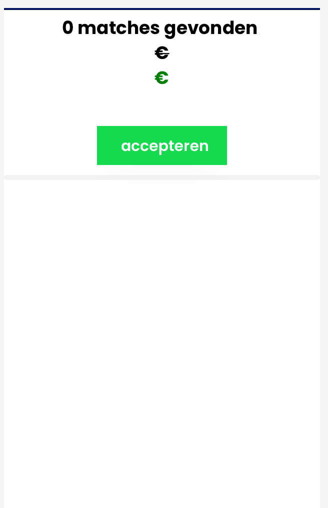

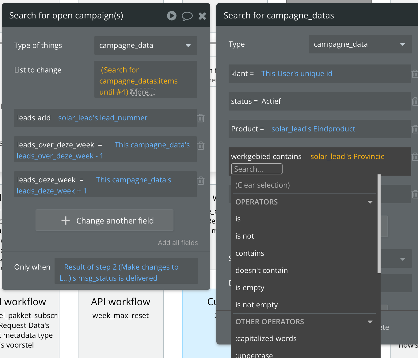

Hi Chris,
I am testing this now, but no results so far.
Created a RG and here comes al of the “potentials” who can get the lead. And added a new field called “Provinices” = (City’s in English). This is a text type, and a list. I added both the current city of the lead, and the moving city to the list.
But, no users show up. So I think this is saying “Only when werkgebied contains BOTH Provincies” , but I want it that is needs to be show up when one “City” on the users field matches the Service area of the user (Werkgebied).
Schermafbeelding 2023-09-08 om 07.39.26
