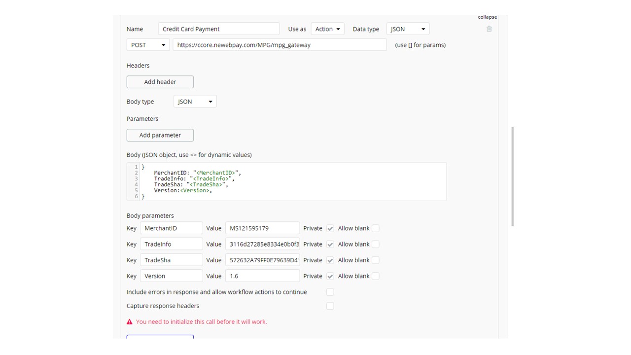

But I was also wondering if there’s a syntax that makes the Value inputs variable? It shouldn’t be hardcoded as it’s different for each transaction. See the image below:

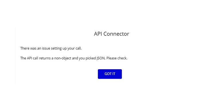

The response type the payment gateway API should be in JSON, so I set the data type as JSON. The payment gateway has offered to send the information back using a NotifyURL function in JSON format.
I tried running it using the setup above and this is the error I get:
Yes, it should be JSON but it looks like it either isn’t JSON or isn’t properly formatted JSON.
So you could change the Data Type to Text and see the output that it returns.
HTTP requests like these usually expect some functionalities to run on the server in response to the request and return the results.
In cases where the server may take more time to process and respond to the request (because maybe it uses another 3rd party service), the server may choose to respond a little later when it has a response ready.
That’s when it uses a notifyUrl. This seems to be a webhook - meaning that it will make an API call back to your Server with the response to the request you made, once it is done processing.
For this, you will have to create a backend API workflow on Bubble and provide that backend workflow’s URL as the notifyUrl.
If that’s how this is working, it might make sense for the immediate response to your API request to be plain text (something like “success” or “OK”) because there is no immediate data to return.

Just wanted to follow up - what would the syntax be on the Bubble API Connector if we wanted the values to be variable?
Just uncheck the ‘Private’ checkboxes on the fields you want to keep variable

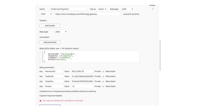

Hi, just wanted to know if you managed to integrate this api, I am integrating Payu (which also uses HTML form Post) and I am getting this error:
Untitled
If you could explain how you did it it would be of great help! Thanks!
