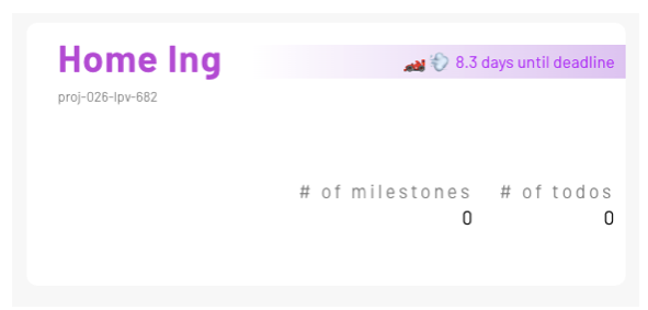

I am now trying to show a repeating groups which shows the number of milestones of a project (done!) and the number of total todos of a project (problem :wink: )
Basically, I am basically trying to count all todos which are related to milestones, which are related to one project.

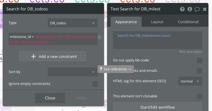

I have tried it with setting up a search within a search, such as :
… but that does not work so far.
I cannot get my head around how to put the Do search and :count algorithm together to achieve that.
Anybody has any idea to help me out?

Hi there, @svenschuldt… if I understand your post correctly (and using a recent post from you that I happened to remember to get a bit more context), I think you should be able to get a count of the to do’s like this… Search for DB_todos:count with a constraint on the search of milestone_id = Search for DB_milestones:first item with a constraint on the search of 1_project_id = Parent group's DB_project.

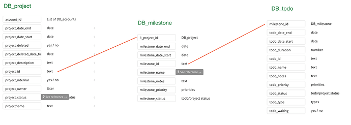

I thought about that - but this is a somewhat different DB design. This is an extract (there is way more to it) of the DB design structure as I have planned it so far:

Also, just a heads up… the id text fields you are showing are not creating the links between the data types.
… is very interesting! Obviously I have a misunderstanding here:
every record in every DB on my side has a unique ID and this ID is being used to connect it with other records. If you say now that
Those links exist because you have tied the fields in DB_milestone and DB_todo to the actual data types, and therefore, the id text fields probably aren’t necessary.
I understand that but they are connecting to the text fields in the first place - the project_ID is a text field and is being referenced within the DB_milestone, right? Same with milestone_id, which is referenced within the DB_todo.
If I would not have them in the first place, how could I tie the tables together?
Yup, you’re absolutely right… sorry about that… I should have been able to think that one all the way through. I’m guessing you could do it with an advanced filter, but if it was me, I would probably add a field for the project to the todo data type.
No, that is not correct. The 1_project_id field in the DB_milestone data type has a field type of DB_project, and that field type ties it directly to a project without needing to make any sort of additional link via a text field. So, to be clear, you tie data types together by including a field in a data type that has a field type of another data type (which you are already doing). Make sense?
That opens up an interesting aspect - the connection is to the data type and eventually the record as such and not via a specific field. If you look at my DB design picture, this reflects a different concept - sort of old fashion apparently :wink: .
I am wondering though what is happening in the background of this process. Some sort of index must be used for tying it up.
