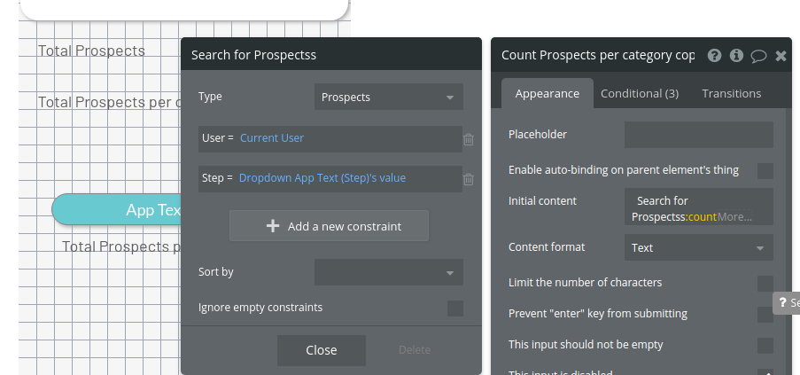

When i want to count how many prospects have each Step values ( 1) Hook, 2) Explanation, 3) Offer …) , the only way is to constraint the research with a dropdown menu value to get the results.

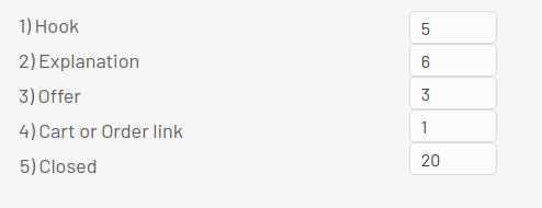

But It’s not very user friendly I would like to have a table : with each steps and the count
Something like that:
FireShot Capture 674 - Stats - mlmprospectmanager.bubbleapps.io
I can’t work on fixed “text Inputs” in which i would write the value i’m searching :wink: , for example.
Unfortunately if I write a searched value in an text input, i can’t constraint the Field “Step” to this input value (maybe because this step is filled by a linked table)
I don’t know if I walk on the good path by working from the Prospect Type, or the :count option with the “do a search for” …

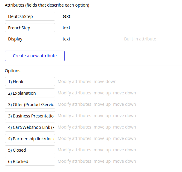

You should look at using option sets for this sort of categorisation, that way you ca just run 1 search and filter the result by option.
Thanks @nfisher, I started to look at it. It seems to be the good way. My first new counts work well :ok_hand:
As I see, I’m gonna have a problem for translations … :wink: I’m used to change the caption thanks to “Conditional” to switch to translated values. I can’t play with conditional to change the source of an Options set, as i can do with table.

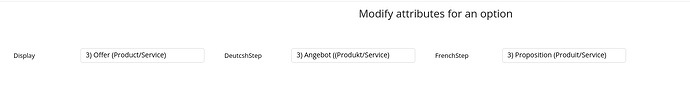

For the follow up and for closing this topic, Multi-language and Option sets can work together :slight_smile:
I decided to use attributes of Options Sets to play with multi-languages.
And after I use Conditional User’s language value to swith to OptionCaption with the right language .
