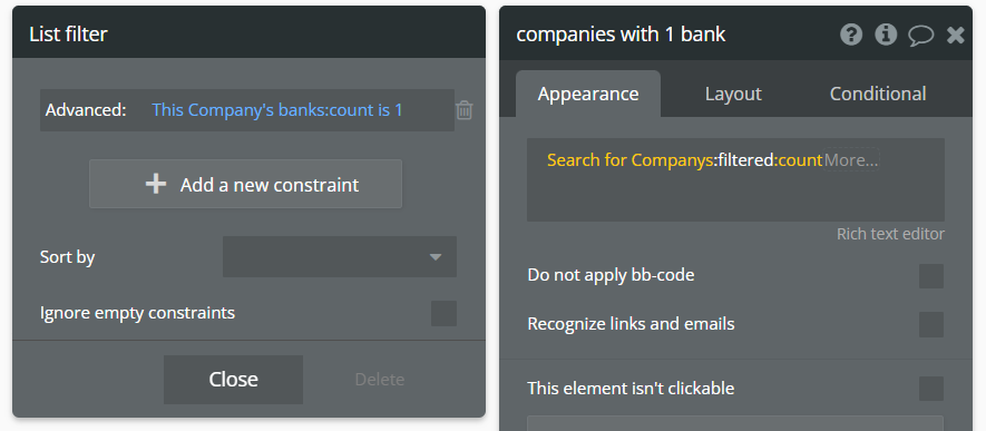

I guess it is a bit more complicated than I made it seem. Here is an example of an advanced filter that does a count of the companies with 1 bank.
Thanks a lot Mike!
