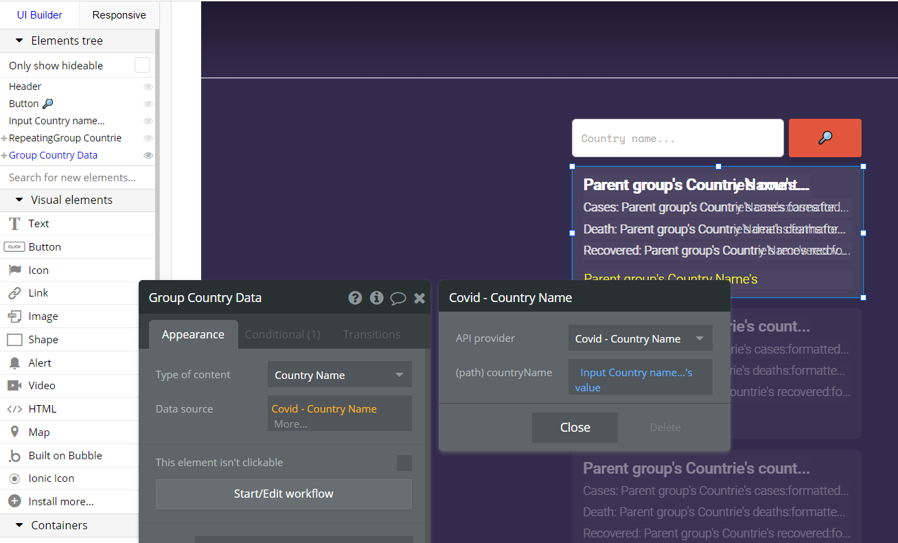

I need help with optimizing the search, as currently I am using probably a ‘stupid’ method but this is all I could think about. Once I click on the ‘search input’ the app stuck for a few seconds and only after shows result.
Link to the editor: https://bubble.io/page?type=page&name=index&id=covid19-20&tab=tabs-1
I am pretty sure someone will have a better solution for it, also if anyone would like to join and has some ideas I’m open to hear :slight_smile:

What am I trying to achieve? I am trying to eliminate this weird lags.
There are only few elements in the app:
  • Search input
  • Repeating group showing api results
  • Group showing search result
Group and repeating are showing/hidden based on custom state.
Hope it make sense.

This method doesn’t work as the repeating group API, and the group API are 2 different data types. Only one of them is a List of Things.
I do not completely understand what do you mean by triggering a workflow. I’ve removed the conditions and added a search button that would show the search result.
The problem remains. (here’s the updated version - https://covid19-20.bubbleapps.io/version-test/)
Well it works as intended now, but the delay comes from the data transfer rate of the API. Like you said it’s two separate data sources, so it’s loading the data from the source again completely so there’s not a way to reduce the wait time.
If you were to just filter the repeating group to show only results with the country data matching the search bar it wouldn’t have to call the API a second time and would appear more instant.
Also, not a terrible idea to have a reset button that reverts the switch from the repeating group to the stand alone group.
