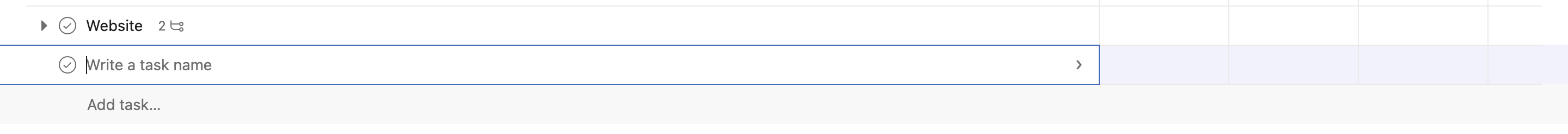

I’m trying to build similar functionality to this:
that when ‘Add task’ is clicked it pops up with empty fields based on columns from the parent board:

What I want is to add the functionality that when a user fills the empty fields and hits the Enter key, or when the user clicks out of the Group Focus, it creates a new thing as it does in the above example which is from Asana.

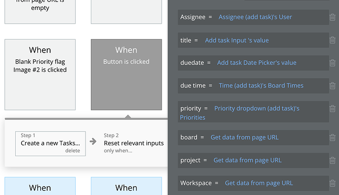

Using the enter key to click the button saves the input field as expected but not for the other fields on my ‘add task’ group. Namely, assignee, due date, due time, priority.
Below is the workflow attached to the button when clicked. Any ideas what might be going wrong? Does this Enter/button click only save one input field or can we make it save multiple inputs/fields?

Yes, you can use a popup for this. Set the popup layout to Align To Parent. Then put a group (A) with full width and height. Set that to Align To Parent too. Then place the inputs group (B) on top of group A. On group A, set a workflow to create new task.
@S2294 Thanks, and to clarify I should use a pop up group, not a group focus?
