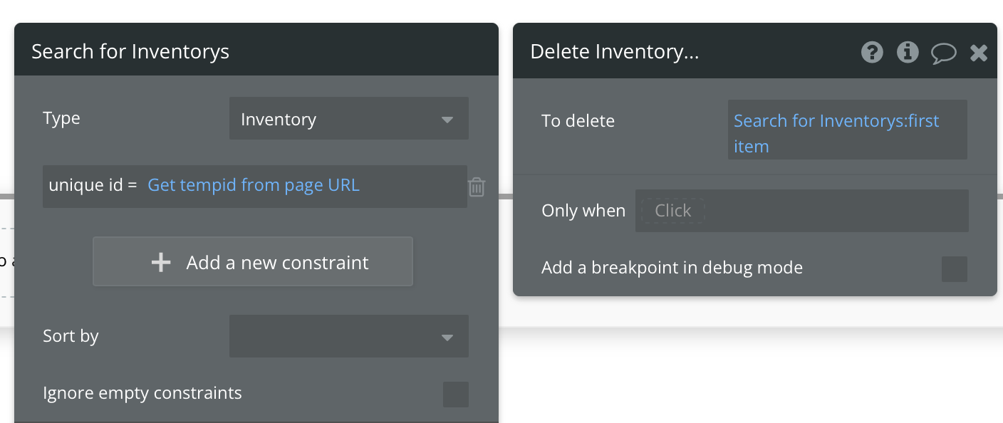

If you need to delete this, then you can just do this:

First, you want to set a new page-level custom state. Let’s call it arg_tempid, of type text.
Click on the page (be sure to NOT click on a page element, but the page itself). You’ll get a popup of the page info. At the top, click the little “i” icon.
You’ll get another little popup where you can add the new custom state.
Once you’ve done that, go to your “when page loaded” event and set the value of your new custom state to the value in the URL.
From this point on, you can now reference the custom state’s value which now holds the unique ID of row of your temporary table. Use this to retrieve the data to display to the user by just doing a basic retrieve.
