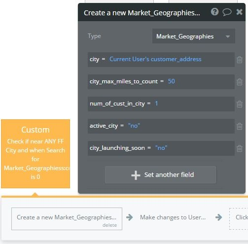

I’m trying to create “a thing” which I’m calling Market Geographies in step 1. This successfully executes because I see the new element in my data. Here is a screenshot of step 1

The issue might have something to do with these 2 errors that I can’t seem to resolve. When I clicked the top error it took me to the first “Thing to Change” but I can’t seem to figure out what is wrong with the statement. Even when I replace:
  • city is within Search for Global_Valuess:first item’s city_max_miles_radius
    with a hard value
  • city is within 50
The error persists.
If you can tell me where the error is in my code perhaps that will fix it. See below
