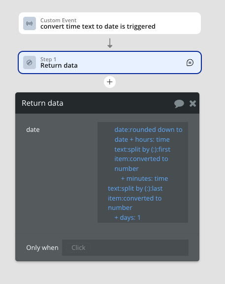

Can you show the action of your workflow where you say the following:
It is done in a custom event because there are a few prayer times that I need to do the conversion for each city.
